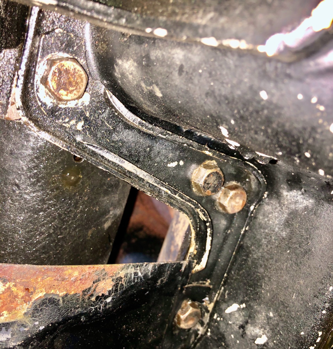

When you do use that 4-dip pan, don't forget to add the factory flange reinforcements, 3118 Left and 3119 Right.
They add the necessary stiffness at the corners.

THANK YOU ALL, THOSE BRACKETS DAN, THANK YOU, NEVER WOULD HAVE THOUGHT OF THEM.

Working on my barn fresh 1925 buckboard taught me that the 4 dip pan was introduced prior to the 26-7 model Ts. It does not have the pan rail reinforcements as pictured. In her gentle life it has not been a problem.

those brackets were designed for a reason, this got me thinking, the pan is supported at three points, the engine and hogs head are two piece,under certain stress conditions like when the frame is twisting with the right front wheel is up and the left rear is up ,this would put a strain on the oil pan in the place where the block and hogs head meet, and if the bolts around the both are not good and snug, this would allow the pan to shift out of shape at this point,when one thinks of it the reason the 26-7- cars have those two bolts added to the hogs head was to stop this problem, I've never seen the rig [only in a picture] that you bolt the early pans to, to realign the pan after its been twisted in this way, but that tells me this has been a problem in the past, with today's driving conditions this type situation is a thing of the past, just the same i'm going to find a set of them and use them. thank you Kevin, its great fun learning these tweaks that make up the model t Ford.

I'd put the stiffeners on any application they'd fit.

I do too. With some trimming, they'll also fit earlier pans.

First of all Richard, a stock 1925 has a 4 dip pan from the factory. I use the stiffeners on all my T's. For a 3 dip, some of the holes have to be elongated to work, but it's not to difficult to do.
