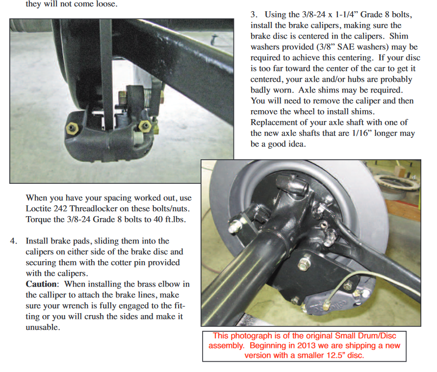

I’m assuming you bled the brakes, and now the brakes are locked up? If so, check that your master cylinder is releasing completely. If your push rod is too long the piston can’t retract to expose the compensation port, which allows the hydraulic circuit pressure to equalize and so release the pistons
Or... if your kit is old enough and wasn’t stored properly, the pistons could be sticking in the calipers. There is a great deal of hydraulic force available to apply the pistons... yet only the elasticity of an o ring to pull it back. A small amount of corrosion in the caliper bores could easily go unnoticed and cause much heartburn

In the first post sounds like you have the parts installed; "Looking for Bill Tharp Auxilary Brake system installation instructions I am sure some one out there save theres. i would like to get a copy i bought a bill tharp set but i believe i did something wrong . claipers are tight around disk and won't come loose. so I am Looking for Bill Tharp Auxilary Brake system installation instructions," You have gone from needing instructions on how to install to needing a list of bolts? The list would not say how thin the head needs to be anyway. You can go to ACE and buy grade 8 bolts and grind the heads down. If you know were they go you should be able to figure how long they need to be.
As it seems to be installed there have been some post with suggestions of why it might be locking up, as were some suggested in the link I posted.
Did you try cracking the valves on the cylinders to release the pressure?
Did you bench bleed the master cylinder before installing it? Top of page 7 small drum wood wheels.
