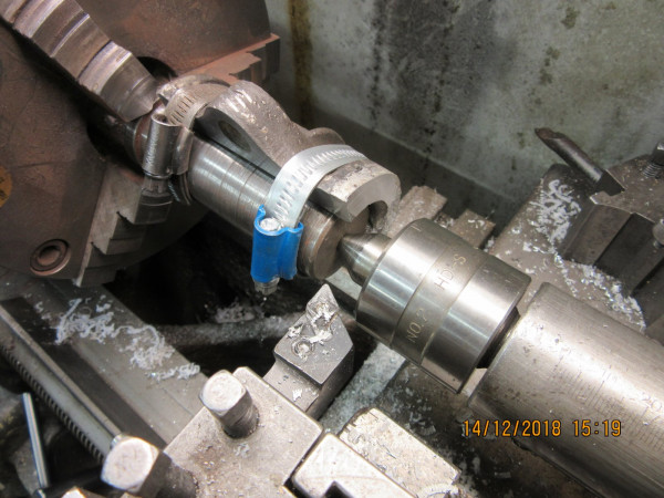

Whatever size the rear main diameter is, turn a mandrel in your lathe to .001" smaller diameter and leave it in the lathe. You can now clamp the rear main in the lathe using another bearing to clamp in place and then face off one end of the bearing. Swap ends to do the other end, but brother, you need to make sure you're setting the crank in the correct location to be able to properly shim the mag.

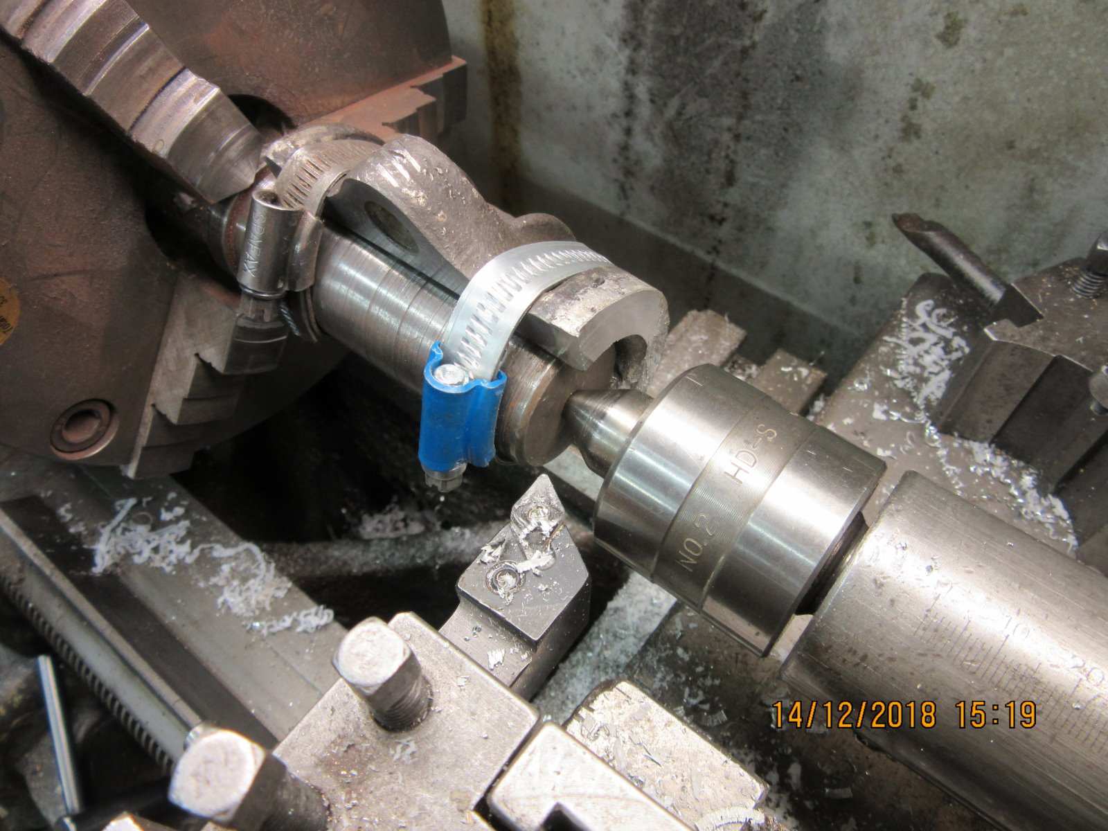

I turn down the rear main in the lathe as on the picture .
Toon

Thanks to all for the information. I was thinking of clamping the bearing to an angle plate in the mill,but the mandrel sounds a lot better.
