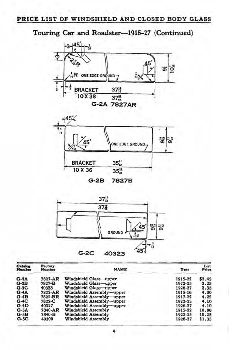

Re: Windshield and glass replacement help needed
This has '24 closed body glass dimensions.
