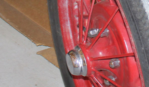

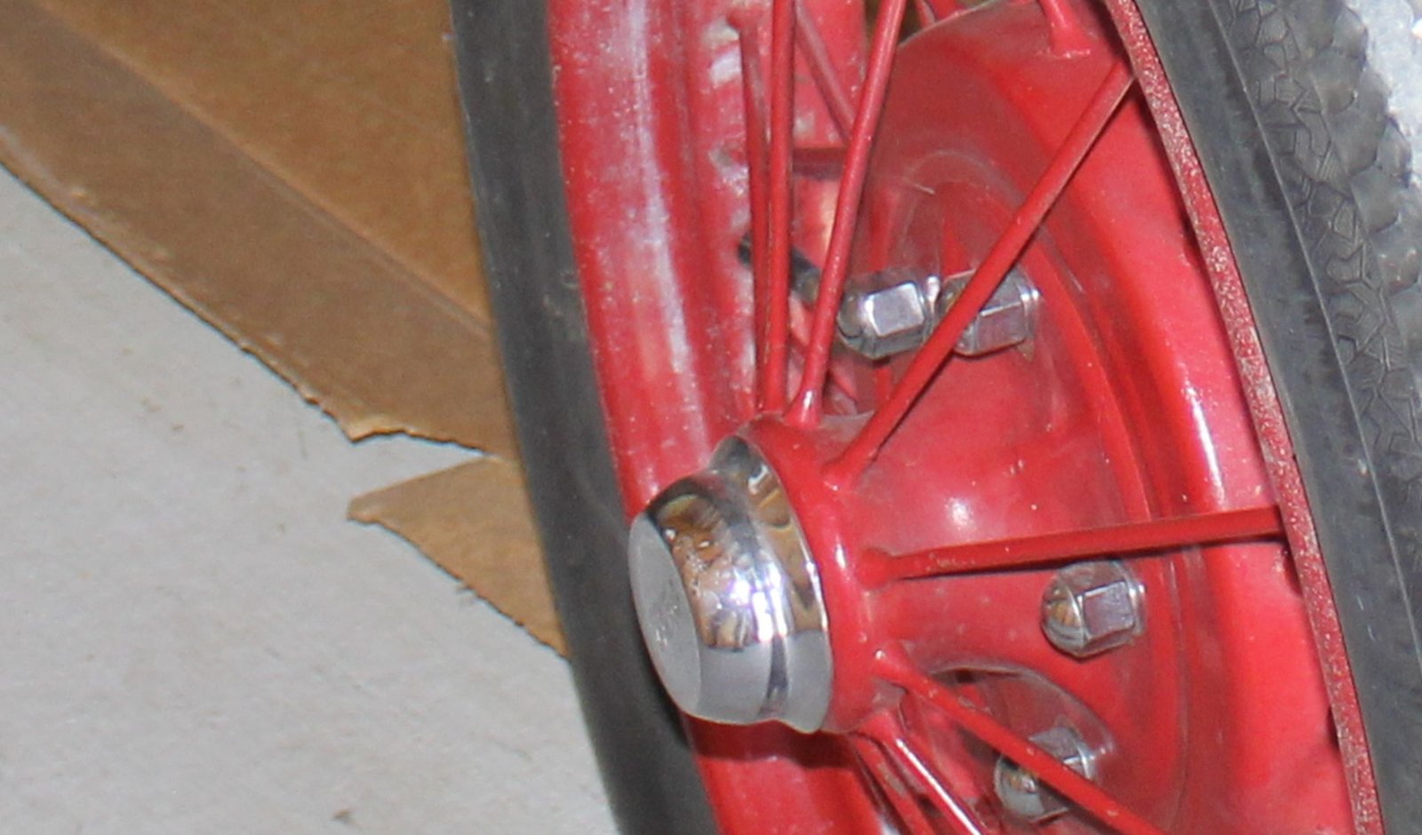

I put four dabs of Ultra-Black right where the cap meets the wheel then bend four tabs only like the others advised. Works real god.
