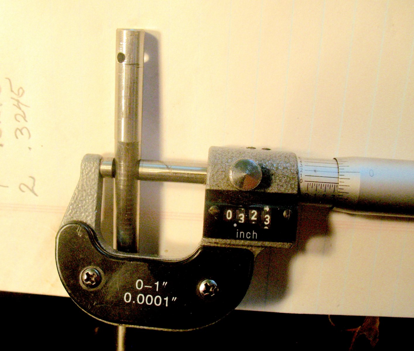

Yes, I wiped the tops of the pistons. I'll get pictures.

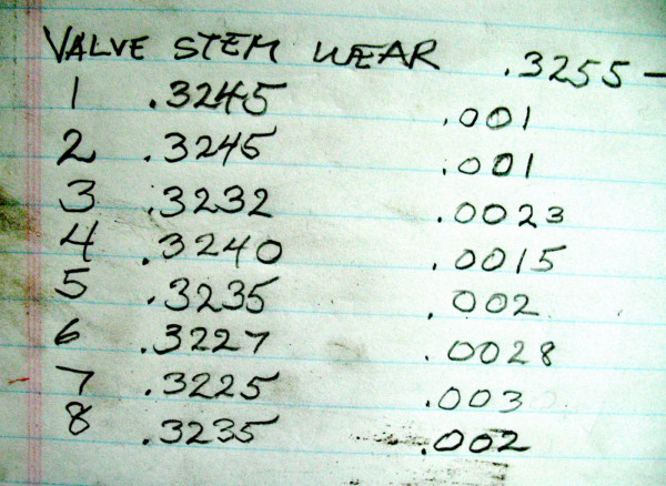

Valve stem measurements. Lang's catalogue shows stems as .312", .327", or .342". The unworn part of these measures .325 with one caliper and .3255 with another. I don't know what to make of that.
All I have for checking the guides is a .327 rod. It slides in easily and has a slight wobble, so there is some wear. I believe the reamer for these was .3275, but I don't have any way of finding how much over that the guides are worn.

Re: The frustration of incompetence
Steve, those valve stem measurements look good. When I was in the business, I would allow .002" of wear on a valve stem. The valve should be free in the guide with a very slight wiggle. An experienced hand can tell by feel. Can you check the wiggle with dial indicator? If excessive, then it would be time to ream to the next size, or replace the valve guides. Are your lifters adjustable? If not, by the time you install valve seats inserts, your valve stems will be most likely too short to obtain proper lash.

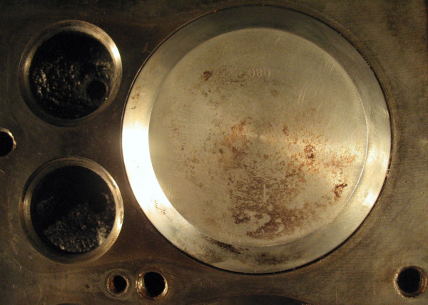

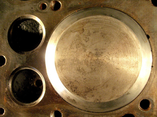

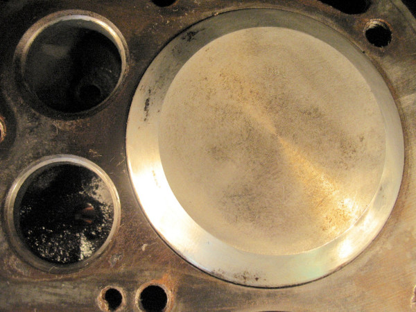

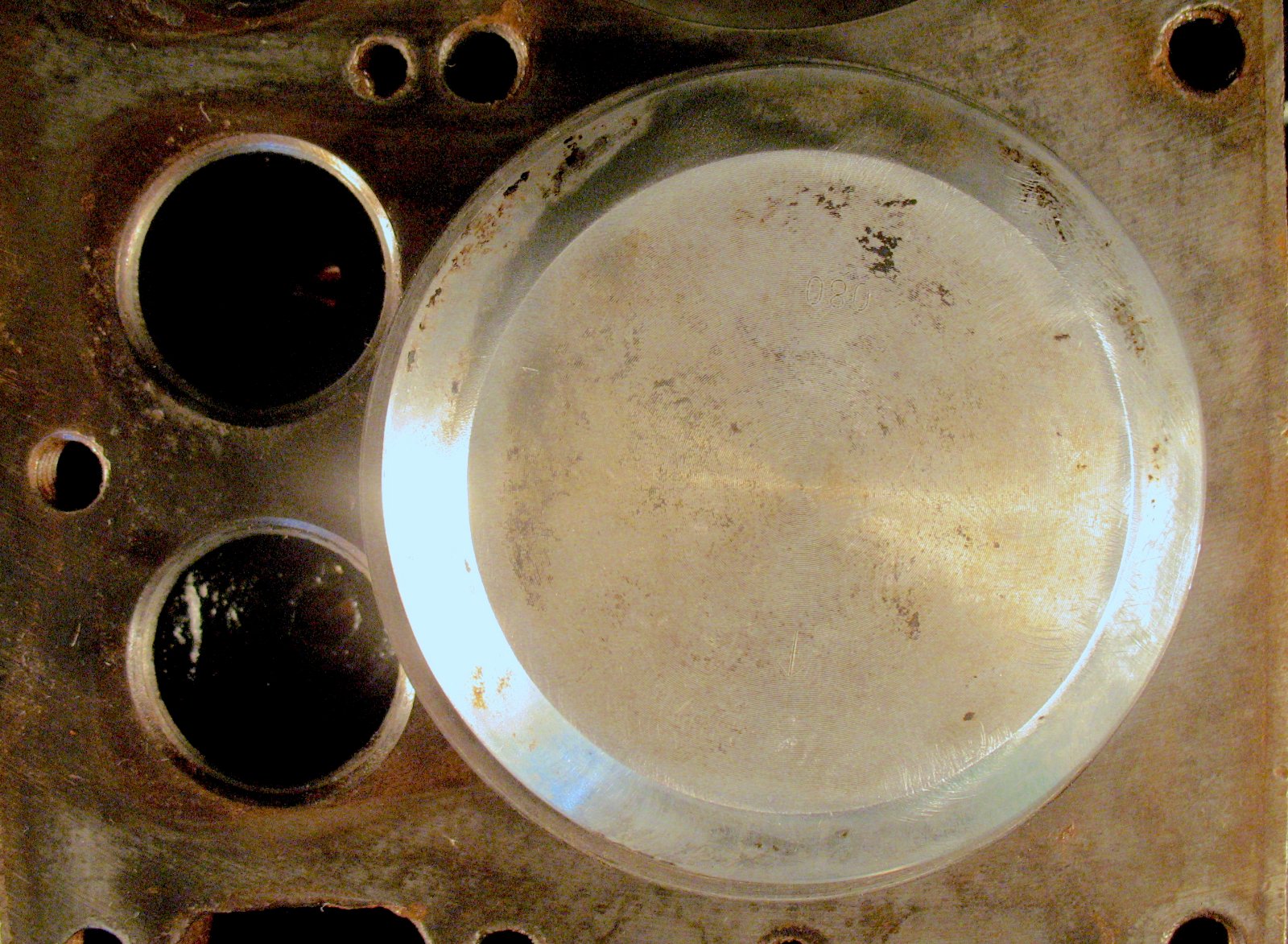

Here are the piston tops in order—1, 2, 3, 4.

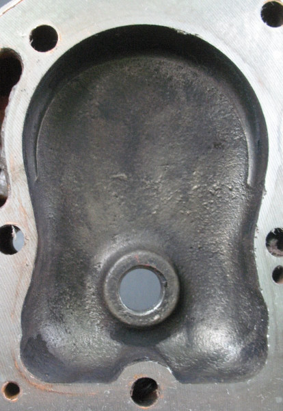

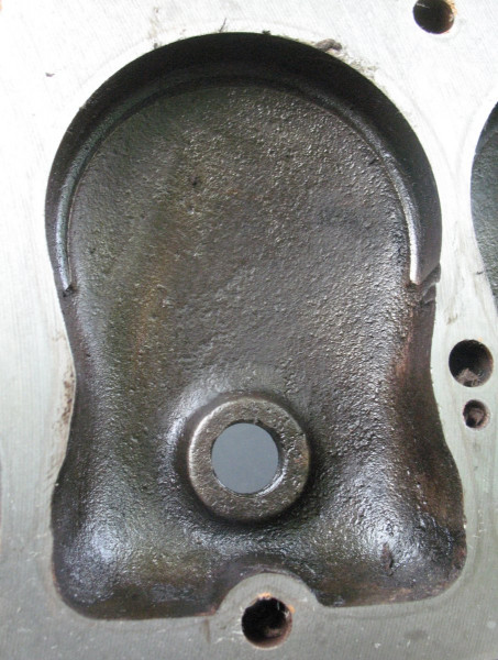

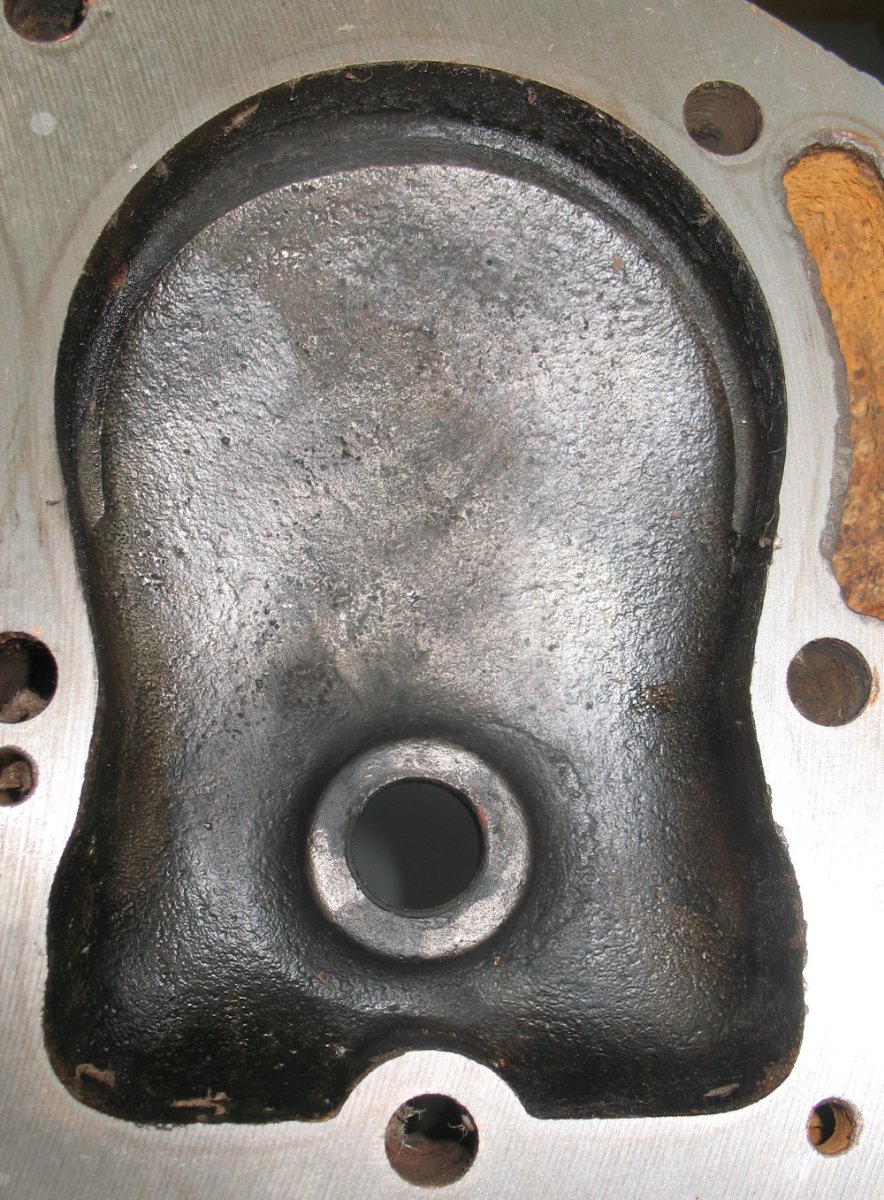

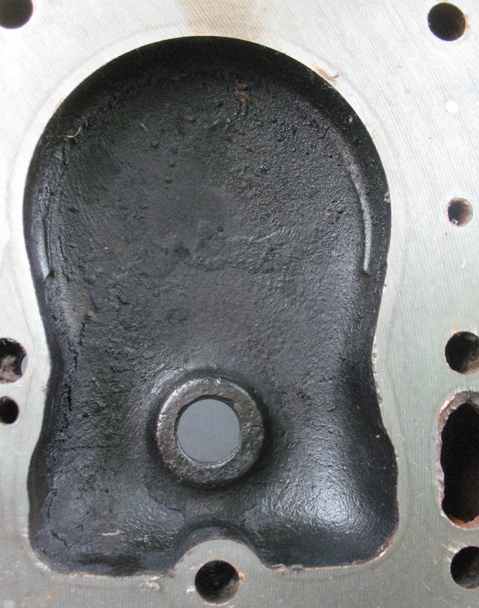

Head chambers. I wiped them but didn't wire brush or blast. Again in order—1, 2, 3, 4.
- Posts: 4479
Steve,
Your valve seats look way too wide, deep & out-of-round. In short, they're used up. I believe you should have valve seat inserts installed and most likely new or reground valves. Even if the rings weren't bad, my experience has been that the act of just removing the pistons, then putting them back in, reorients the rings in such a way that their wear patterns now do not match those of the cylinders. Along with new rings, a touch-up with a hone is also in order to help the new rings to seat. I don't feel that the cylinder wall pitting is a huge deal. Would be nice if it weren't there, but I wouldn't bore the cylinders to get rid of it.
The vertical scouring bugs me.On a 2 cycle engine if you can even see vertical scouring it will affect a engines running.The ring can't seal that vertical mark. I would be wondering what caused it.
I'm happy to allow that it might be a camera illusion, but:
What I see in all the pictures of the valve seats, is that they are not concentric. Every one of the seats seems wider on one side than the other. It's as though they were cut with a tool whose guide shaft was bent. Or it was loose in the valve guide, and the operator leaned it to one side.
This can't be good. The valves are more or less free to rotate, so they can't adapt to a non-concentric seat.
Please tell me it's a camera illusion!

Wow. 80 thou. over. Could that be part of the problem?

On running a hone through the cylinders, you have nothing to loose. I would try a fixed stone hone first. If you can still feel the rust pits with your finger nail, I would then try a ball hone and see if that helps. I also recognize it is not that much work to re-ring a T every so often if the rust pits cause an ongoing problem. You may get years between problems.
If you decide to go with the existing bores, you should address the piston scoring. I did this myself several years ago on a newer complete rebuild. I chucked the head of the piston up in a lathe and sanded the skirts with WD-40, 220 grit wet and dry, and a sanding block. That nicely cleaned the pistons up. The manufactures specs for piston clearance were to tight. I now set the clearance to a minimum of 3.5 to 4 thou.
When you put it back together. remember to check the ring gaps in each cylinder.

Topic author - Posts: 7413
I talked to Mike this afternoon and told him I lack three things to deal with this situation. 1 Sufficient mechanical experience; 2 Talent; 3 Confidence that I won't overlook something and screw everything up. He has a full plate right now, but in a couple of weeks I'll call him and make an appointment to haul this engine to Tulsa and get some help from somebody who knows what he's doing. Meanwhile, this car needs other things done to it that I can readily do myself without fear of ruining anything.
Yesterday I took the short block to Tulsa for an examination by Mike Bender the Model T surgeon.
The cylinders checked out OK for roundness and taper. The pistons are fine. The valves are getting low enough in the block to call for new seats, so we're going with new rings, valves, and seats. But Mike thought the overall condition was pretty good, and my low compression readings may have been from a faulty tester. So if the hard-start/no-start problem wasn't caused by compression I'm back at square one. We'll see how it is with new seats and valves.
