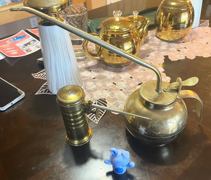

Two of my oil cans arrived a few minutes ago and the smaller one had a little bit of oil in it and it functions just fine, I filled it with gear oil, and she’s already in service.
The bigger one looks to have had something in it that congealed and will need to be cleaned. The mechanism for the pump appears to be functional and one cleaned, it will function just fine.
Neither appears to have any gaskets and rely on brass fitment to pump.

since the smaller oil can had clean oil and was working I didn't bother to take it apart, just added oil, and my son lubed the oil cups.
The second one had two ball bearings in the mechanism, one broke free easily and is in good condition.
The second had to be tapped gently and has quite a bit of corrosion, I cleaned it up with a wire wheel on a dremel, and it now functions fine. if I think about it some day I'll get a new ball bearing.
The congealed crud and rust are scraping off just fine. I put a whole mess of nuts and bolts and a mixture of pb blaster, carb cleaner and waste oil in it to swirl around...

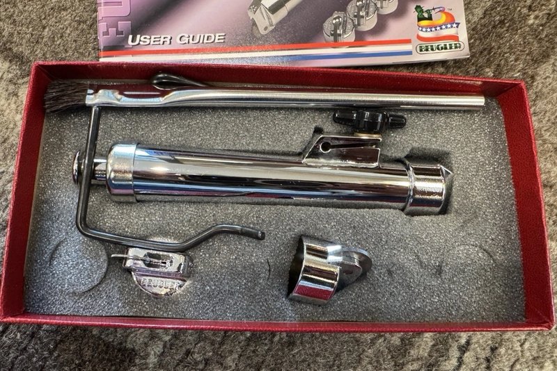

Regarding the pinstriping set. Those sets require skill to use. Might be far less frustrating to get a buegler. A good friend of mine turned me onto them, you've seen his work I'm sure...
https://www.beugler.com
I still haven’t gotten the paints yet but I did find a new/unused beugler striper for really cheap on the ebays.
I’m still going to get a kit with brushes, gut after watching a few videos on the tool, it may work better for what I’m trying to do.
I can get fancy with brushes later.
This tool has three different wheel widths

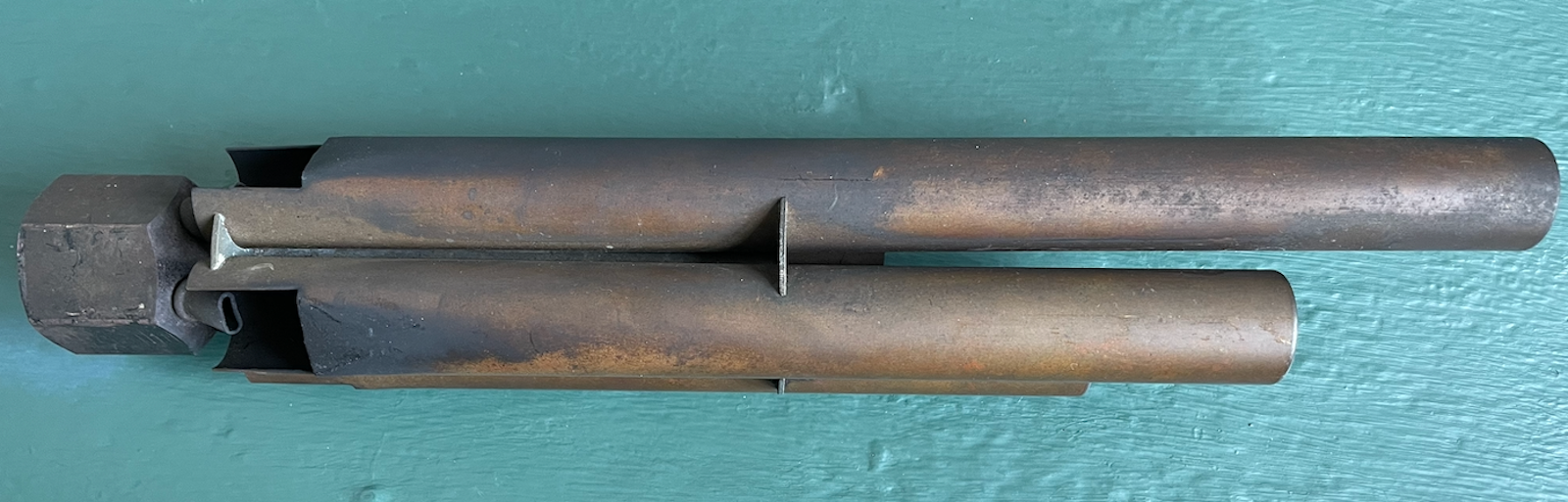

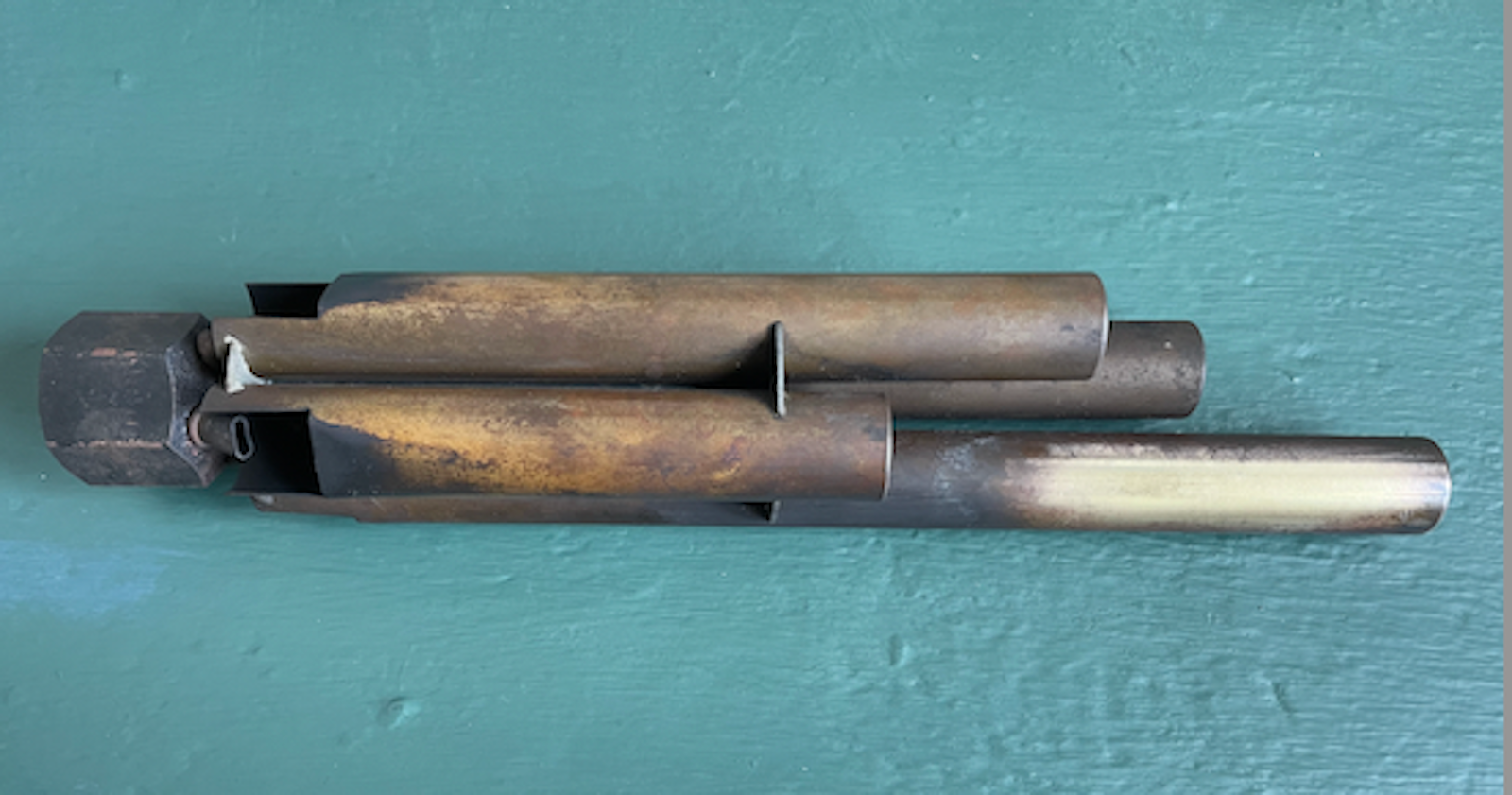

I have fixed the oiler scooper thing off cylinder #3 and have her buttoned up and back on the road.
I also learned I need to lube my anco slapper timer every 200 miles or so (it’s been 600?) I have an ancient tube of dow 33 and I looked it up and it’s a hi temp lube so on it went.
A club member said that while the clutch disk piece is unusual, as long as it drives, don’t mess with it.
No other oddities were found in the oil pan.
The scooper was sheared off and the spot welds were still intact.

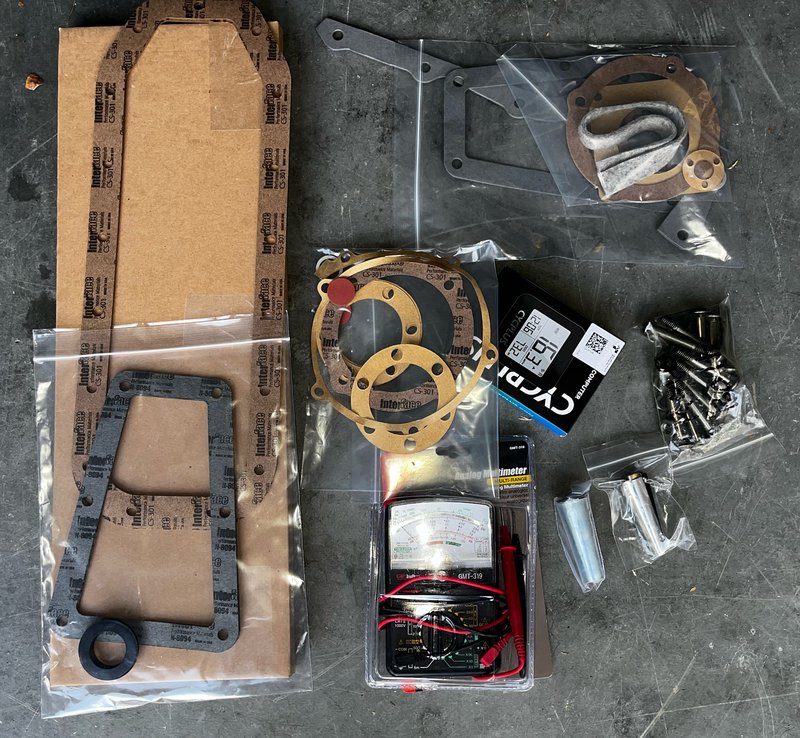

I did, just now order an analog multimeter, and I figure I may keep it in the trunk maybe....

I only needed one 4 dipper pan gasket, but I clicked on a bunch of different gasket sets and a set of hub bolts and other odds and ends and an analog multimeter and a gps odometer/speedometer.

OMG! that @!#$$ fiat again! I could walk faster...
then somebunny obviously high on some substance pulls out of a parking lot in semi-heavy traffic and proceeds to drive 5-7 mph... at least they stayed in the slow lane...
I have the explosion whistle adapter in, and while not ideal I am certain I can make it work. I'll stop by Napa on the way home to get a long reach 14mm spark plug and compare it to the stock plug performance-wise... I will install at least the adapter with the whistle side plugged off to test performance...
Is there a current production long reach 1/2" npt plug available? anybunny got a part number?

Post by WillyR » Tue Aug 05, 2025 9:55 pm
My autolite plugs didn’t arrive at Napa
It turns out I have champion x plugs. It looks like the reach is about .75”
So I used it with my adapter.
Seems to run fine without load, I’ll see how she acts on the way to work tomorrow.

Post by WillyR » Wed Aug 06, 2025 9:13 am
I don't think the spark knew or cared that it was a 1/2" from where it used to be....
the drive in was unremarkable...
I'll pick up my spare autolite plugs and toss em' in with the other spare parts....
that was a lot of concern about nuthin'

reposting this here for continuity... from my explosition whistle britches thread...
I looked at the specs on the champion X spark plug...
I says they are 1" reach... I'm not sure if they are measuring base to tip or what, but that's not what I was measuring.... below is a picture comparing to a banana...
I was being generous saying it was 0.75"
I was going to just check the tuning with the adapter and plug off the whistle hole, but I couldn't find a plug for the whistle hole.
I had shot some used motor oil in the whistle mechanism last week, and had expected to have to take it apart and re-seal it, but it seems to be functioning perfectly....
I'm happy I got all the noise makers I have learned about, but so far this one is the least impressive sounding....
I don't know if I have a true favorite, maybe the bevins bermuda bell?
If the cutout for the aermore wasn't so leaky, it might be my favorite, but I haven't taken it back apart to see if my fix will work, maybe sunday?
