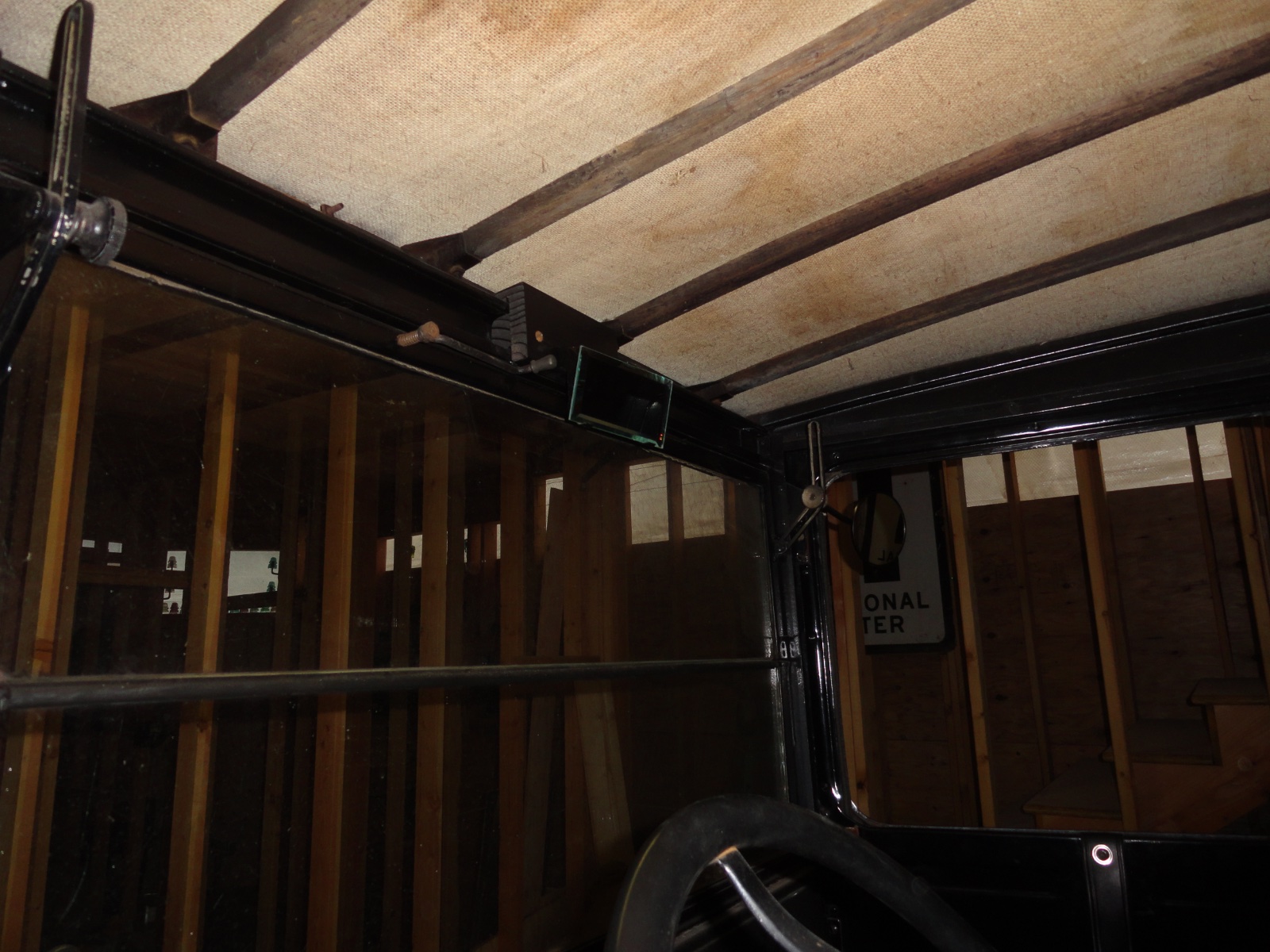

Original top framing. Overlaid with canvas, an unknown padding, and a diamond pattern
top fabric.

Thanks! Is that white canvas? Is the outside canvas or vinyl?

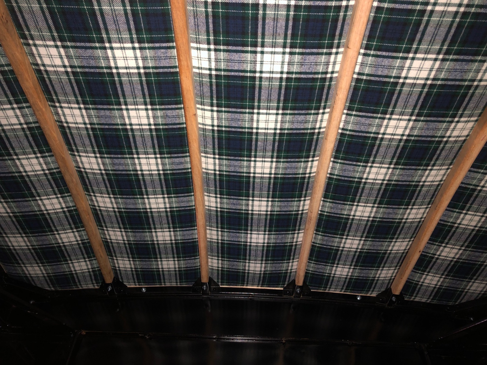

Here’s what I did with my top. Same general process.

Thanks Brad, that’s exactly what I needed. Did you leave the flannel showing for a headliner?

I sure did! I didn’t want to be looking at plain black/tan/white muslin. Too boring. The plaid material I found is stronger and more weather resistant anyway. Win-Win. I’m documenting the crap out of this build so keep a look out if there’s anything else I can help out with.

It is a natural colored burlap sort of canvas, just like old feed sacks. It is faded
and weathered and has a few water stains. While I can't swear it is original to the
factory build, many, more knowing than me, have commented that it looks to be
"correct" OEM. Exterior is a vinyl-like material, similar to what was OEM for 50's
convertibles. Likely from being replaced at that time.
