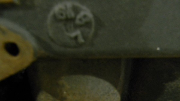

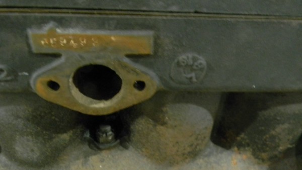

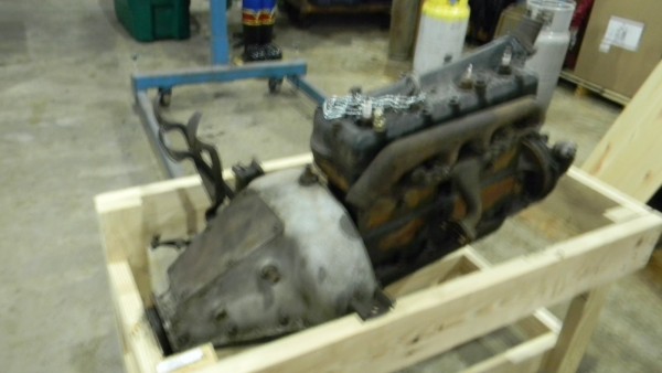

I got this engine from a customer, has been re stamped with a 1915 number also got title with this but the casting date is not what should be on the block, look at photos please, Bob
any idea of the year of this engine

Bob, I will take a stab at it and defer to others far more experienced. I see a casting date of July 8, 1919 so it can't be a 1915 engine. But what about the fact it is a non-generator-starter block? In the CD encyclopedia the Ford Engineering drawing dates indicate that the cylinder block T 400C was obsoleted on July 24, 1919 and replaced by T400D, the starter type of cylinder block. The info in the encyclopedia also indicates that the actual change to the parts could occur before or after the dates of the engineering drawing dates. So my thought is that you have a 1919 engine that was cast during that change over period between non-starter and starter cylinder blocks.

You're correct, its a 1919 early without generator casting on block.
Bob's is dated July 8. Was re-stamped for '1915' numbers, maybe to sneak into HCCA early tours. :?

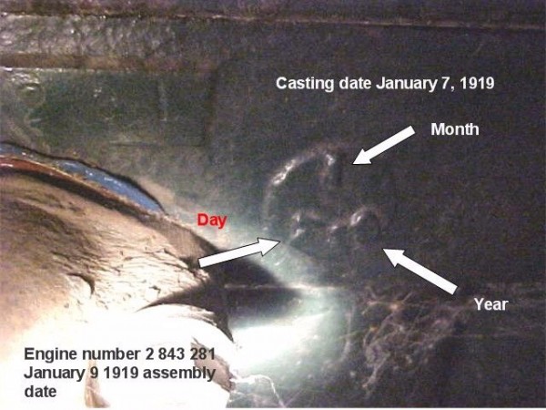

Diagram for reading dates on the clock face casting patterns of later blocks, saved off this forum.

Looks like it was a 1915 engine, but with a replacement block from 1919. US production used that "circle" casting code date for about three years, roughly 1919 through '22. After which US blocks stopped using date codes entirely. Canadian production blocks used circle date codes for many more years. Very unusual to find circle date codes on a "no generator" block! Most no generator blocks were early enough to still use the in-line date codes. It was not rare for replacement blocks to have no serial number from the factory, and then be stamped the the original block's serial number. Usually such blocks were used to replace original blacks that had been damaged beyond repair. Although that is not a given. It is possible for two engines to have matching serial numbers. I seem to recall hearing of it being found once.

So it seems to be early 19 but replaced and stamped to 15, cool, will be listing it for sale with a clear 15 roadster title, Bob

Regardless, it is a markedly late non generator block. Blocks began appearing for the generator somewhere around November or December of 1918 for the generator equipped enclosed body cars. Open cars and TT trucks continued getting the no generator blocks until about February or March of 1919, after which most open cars got block-off covers for the generator. TT trucks continued getting the no generator blocks until early in the 1920 model year. I do not know, but would suspect some replacement blocks were produced in the no generator style until late in the 1919 year. Ford would not have continued the practice for very long because the problems with inventory control for both generator and no generator blocks would have outweighed the savings of using the old forms. No doubt dealers were encouraged to get rid of the earlier style blocks quickly to customers with earlier cars.
That block technically would not qualify for active HCCA use. Although, in practice? Probably nobody would actually call it out. I have never seen heavy enforcement of those rules. Never seen cars checked for compliance on any tour. And in fact have known of cars that ran later engines (supposedly for the addition of a starter for aging members, even though changing the block is NOT necessary for adding a starter). And many HCCA cars use Ruckstells and '20s era wire wheels or demountable rim wheels in spite of the fact those also technically would violate the HCCA rules.
Another little secret, or reality check. Although technically not covered in the rules, cars are generally allowed to participate with later engines provided the car owner has possession of a correct engine. (Later engine must be basically like the original engine, later model T engine in a model T, later Reo F-head four in a Reo F-head four.) "Correct" engine should not be any newer than one year newer than the car originally was, and must be pre-January '16 regardless of car's year (therefore a late '15 build automobile cannot have a one year later engine although earlier cars can!).

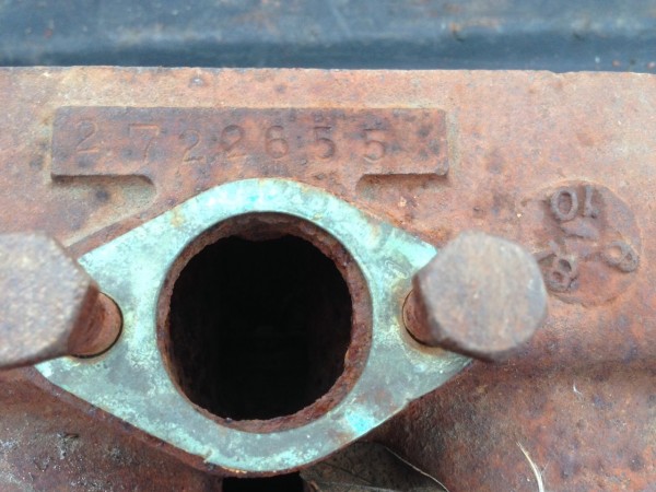

Although the circular casting date is generally considered introduced in 1919, they actually started showing up early as mid 1918. I have two 1918 blocks with a circular casting date, the earlier one (June) shown below, and have seen one other.
