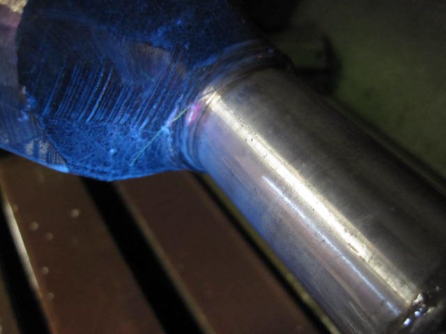

Here are the results from the mag particle test on my 1911 crankshaft. No radial indications, linear indications show up on some of the journals. Should I be concerned? or are these surface cracks that can be polished.

Was debated several years ago, more than likely in from new and consensus was nothing to worry about. Cranks have only failed with radial cracks.

Was the crankshaft washed and all grease and debris removed before crack inspection?
You won't get a true reading if there is oil or dirt on the crank.
From what I see those are a result of the forging process as long as they are away from the radius of the crank.

Sure I'll buy another crank as long as you want to sponsor me, not going to happen with my budget. When I picked it up the tech put it back in the mag machine and showed me the linear surface cracks, he said he found no radial cracks of any kind. I surmise they've been there for 107 years so why change now. I'm going to polish the journals and assemble.

Leaving an original crank in a block of any higher value, especially a crank with ANY found defects, is like driving your modern car with no insurance and just taking a chance on paying the bill if anything happens.
A real nice 1911 block would probably sell for a low of $2,500 and maybe around $4k under just the right circumstances (close date and a very correct restoration). A new Scat Crankshaft is $1,695. Yes, it’s a big added expense, but broken cranks in early blocks generally destroy the block a vey high percentage of the time and they can’t be fixed.
Another thing to look for on your crank is the forging mark. This is the trademark of the company that manufactured the crank for Ford. Quite a few of the early T cranks were forged by Cleveland Hardware. Their mark is a letter C superimposed over a letter H. These crankshafts have such a bad reputation for both finding cracks and breakage in service that many rebuilders and some very experienced hobbyists probably wouldn’t use one in a rebuild even if it checked out fine. If your crank is of Cleveland Hardware manufacture, it would be best not to use it and substitute a later good crankshaft, or a new one.

Those linear indications are not cracks. They are forging flaws that were there the day that crank was made. I would not hesitate to use that crank, based on those results.
