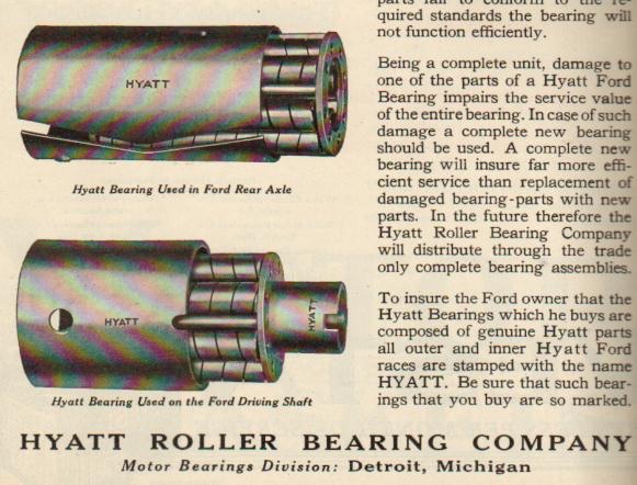

William
That's an observation I haven't had, pulled a lot of Hyatts from axle and pinion, and never seen felt. Only old tar like grease, metal particles if the sleeve had been worn down.
No mention in early articles by Fahnstock or Hyatt adv. about felt inside the ribbon roller. Would add too much resistance IMO.
