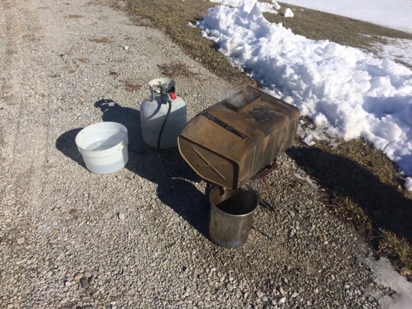

I pulled the tank for cleaning tomorrow.
Tar & beans

Tar & beans
I do not think it will run on TaR & beans

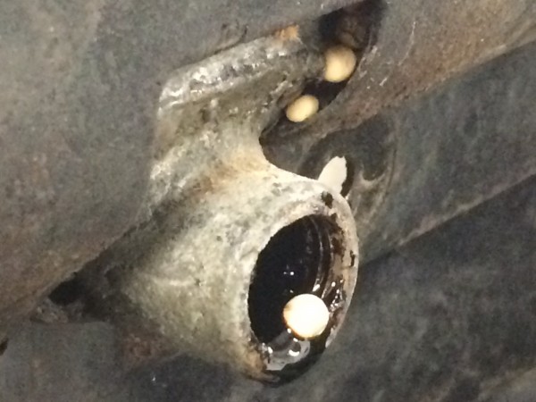

D.Yoder
Topic author - Posts: 263
- Joined: Sun Jan 06, 2019 2:50 pm
- First Name: DEAN
- Last Name: YODER
- * REQUIRED* Type and Year of Model Ts owned: 19tour,24tour,25rdpu,27rd.26coupe,TT's,& tractor conversions
- Location: Iowa
Re: Tar & beans
Cleaning started

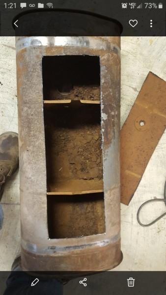

Re: Tar & beans
Here is how I cleaned my tank.. cut the bottom out, cleaned it an welded it back on..[image][/image]
