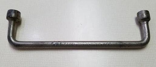

Black Hawk and Walden-Worcester made similar sparkplug/head nut wrenches and the carb/generator wrench is up there with sliced bread. :lol:
