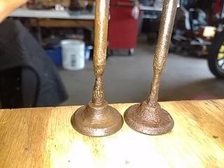

I started doing the same thing with a 26/27 block. Been soaking the bits and pieces with Kroil for a month before starting. Got the lifters to start moving down so I could work on pulling the non moving camshaft out. Someone had cut the valve stems leaving very ragged ends so needed to do some cleanup on them. I got down real close to work on them and noticed that the lip that seals the valve cover looked a bit odd. Wire brushed it then traced the crack up to one of the exhaust ports. Ah poop!
