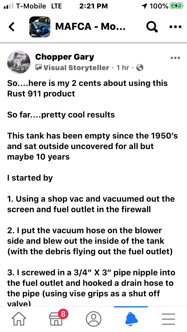

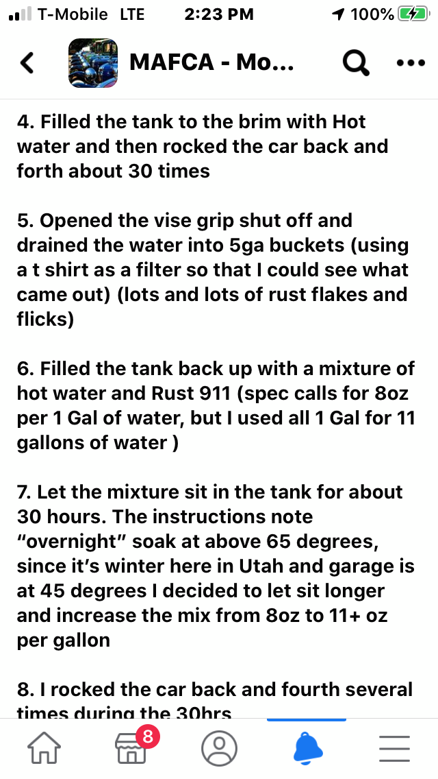

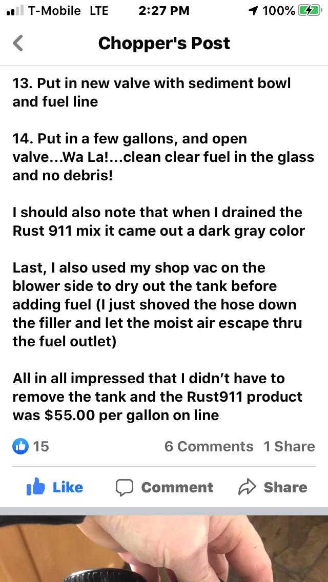

This guy had great results with this product.
These instructions are for a Model A but the procedure about how to flush the tank should be the same.
I am not sure if you can use the mentioned product more than once.

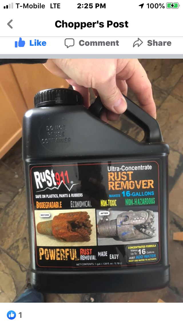

Um,may be a viable alternative to sandblasting and such for alot of parts.I think I read something about the 16 gallons would clean 600 pounds of metal?
I don't have much knowledge of chemistry. But lets say i wanted to clean the lock rings for a TT rim, would this chemical be safe as far not affecting the metal? What about springs? I guess you could put some in a plastic pan and turn a T engine block upside down in the tub over night and clean the water passages really well.Might even help unstick parts like the valves and pistons on a rougher block?
The possiablitys are endless if it won't hur the metal. I would think maby check to see if babbit is another concern?
