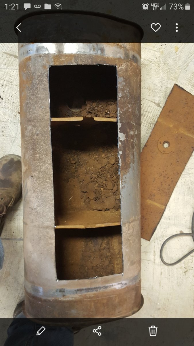

Here is how I cleaned my tank.. cut the bottom out, cleaned it an welded it back on..[image][/image]
