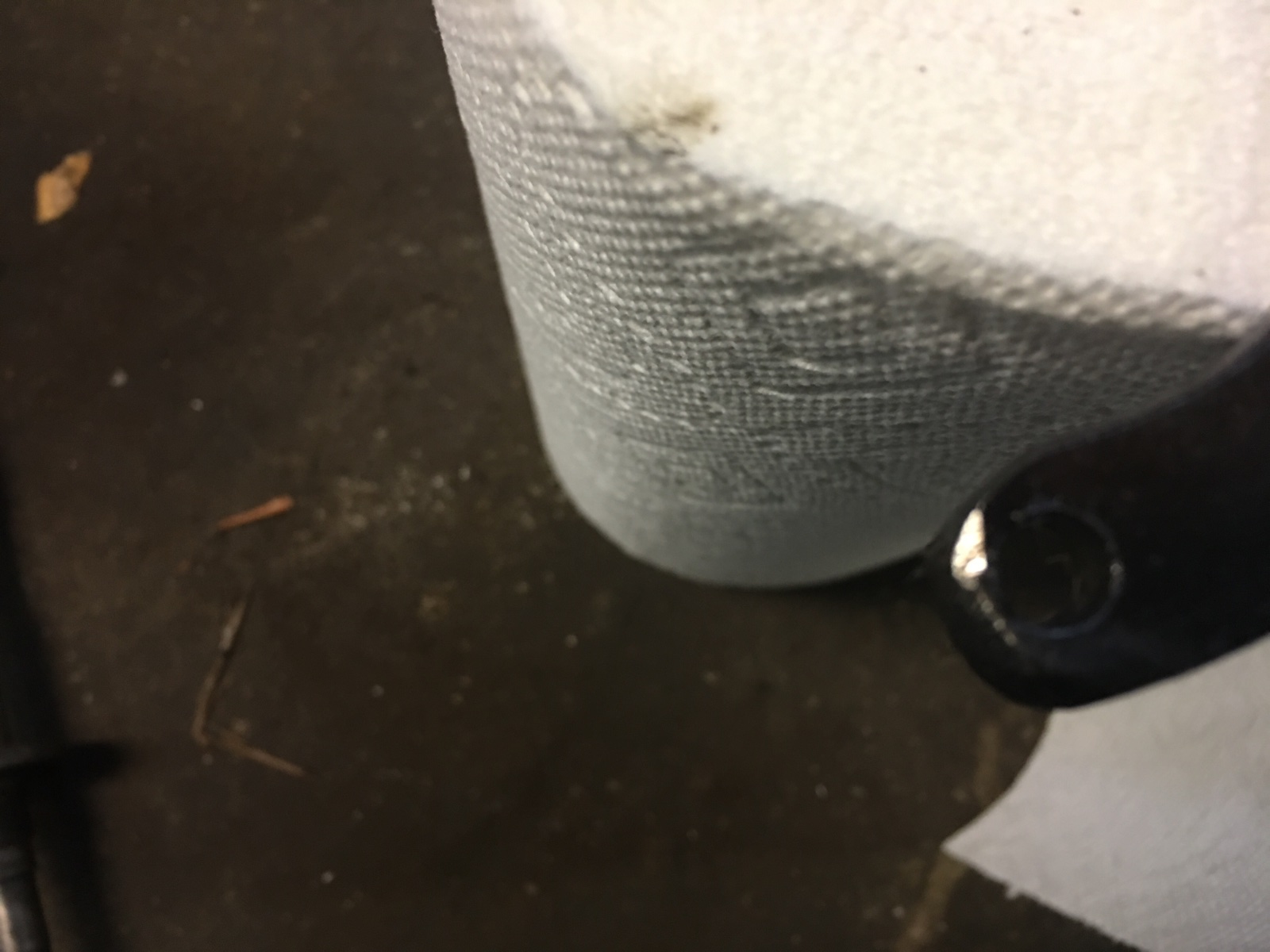

Some months ago the crank in my 14 Touring broke. Eventually I replaced it with a Scat but the engine was noisy. To my ears it sounded like a camshaft noise. I checked the end play, only a couple of thou thanks to the Chaffin Kit that mounts on the front lof the cam gear wheel. With the upcoming tour in Sierra Vista, I decided I could not take the car with the noise so I kept looking
When you use the Scat crank with a four dip pan, the counter weights come very, very close to the sump and there is no space for the “U” shaped bars to hold the inspection cover screws. So I chopped the U bar in half and made two “J” shapes.
One just touched the counter weight. On the picture you can see the shiny bit
Shiny bit on end of J bar

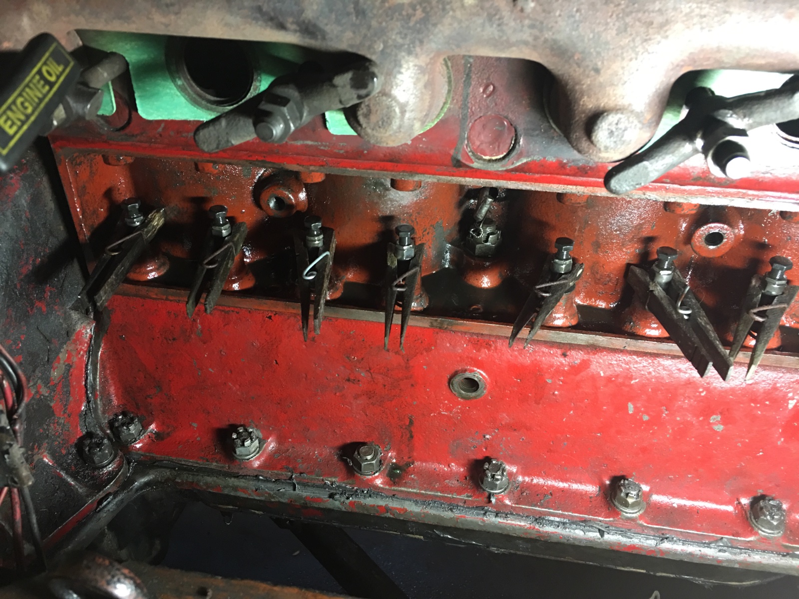

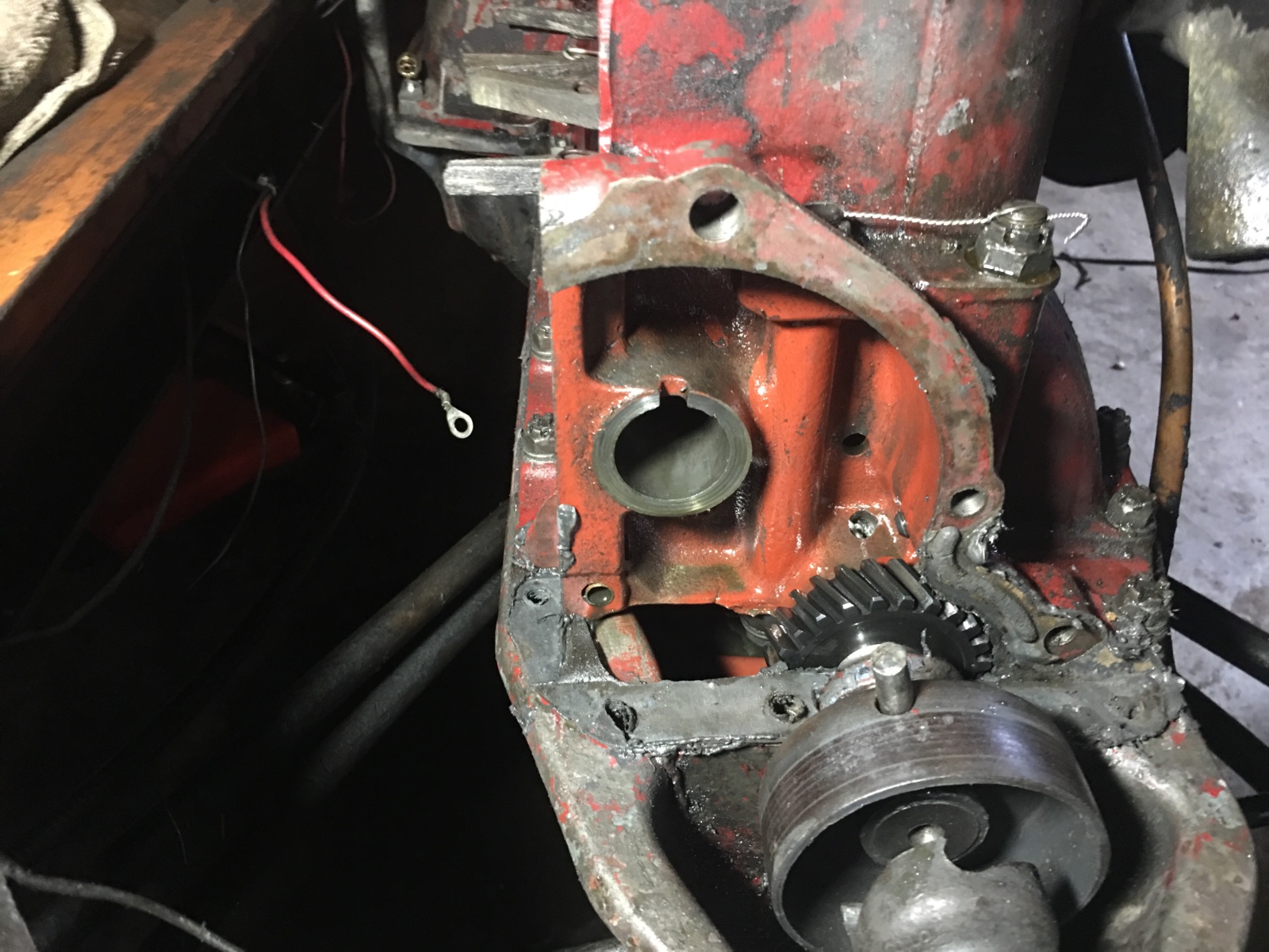

By the way this gives you some idea of what I disassembled to find the problem.
Nite the pegs to hold the tappets
To expose the cam gear and remove camshaft

Is your crankshaft a standard T stroke? I have one in my 26 and don't have a problem. I would suggest that you grind just a little off the J shaped bar in the position the crank touches it.

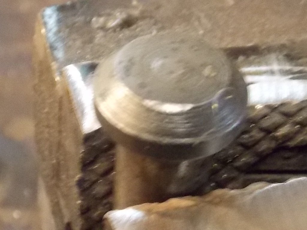

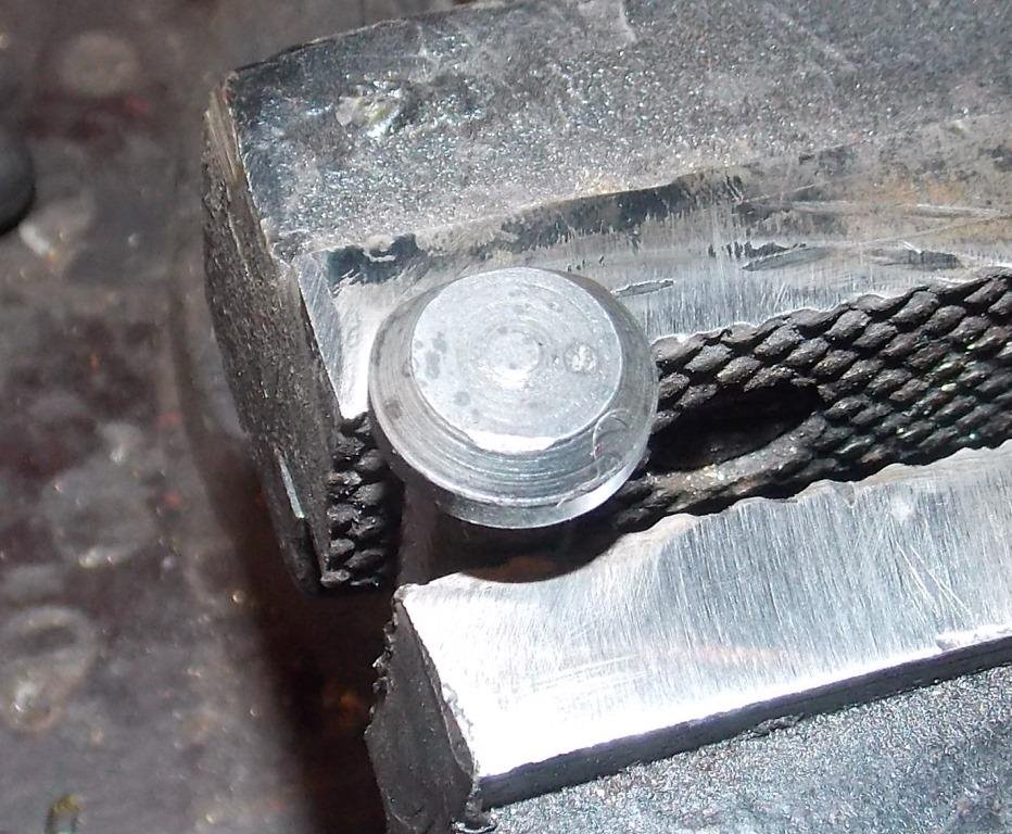

Did you check the rod bolt heads of the second piston at the camshaft side.
Last year someone brought me an engine with a strange knock. The owner did an overhaul with new crankshaft new rods new pistonsand rings new valves and seats . Since the rebuild there was a knock he couldn't find.
This what I found:
Good luck

2) Rod bolt head is tapping against the cam (Especially if you are using new bolts. Often the heads are too tall.)
