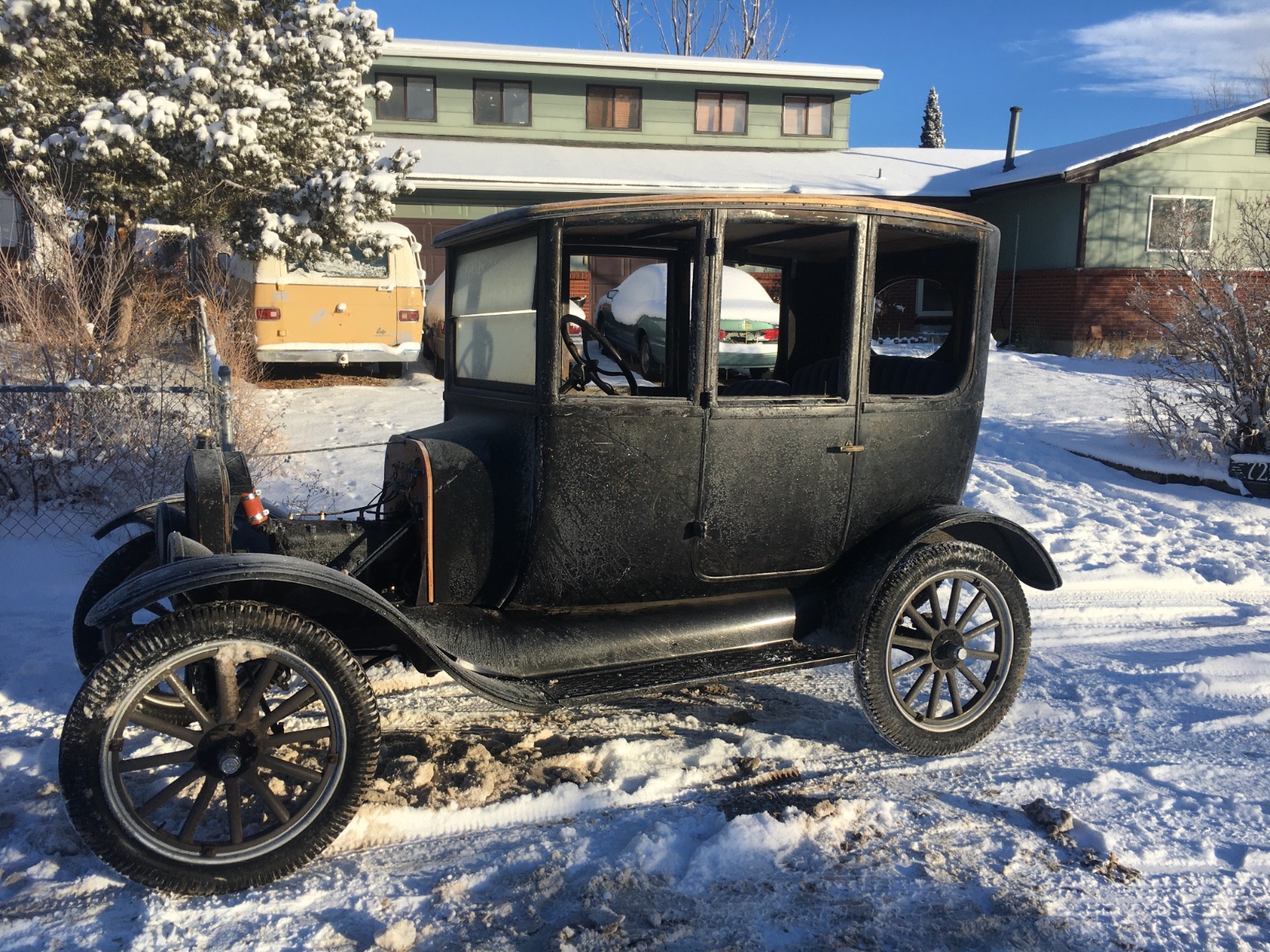

Re: 23 center door rear window install
just after we unloaded her saturday morning
That is a beautiful photo.
Thanks for sharing it and the details.
- Posts: 6613
Very neat
washwashwashwash then rinserinserinserince that thing when you can and get the salt off. You will not believe the nooks and crannies these things have
