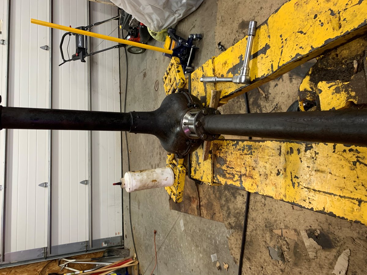

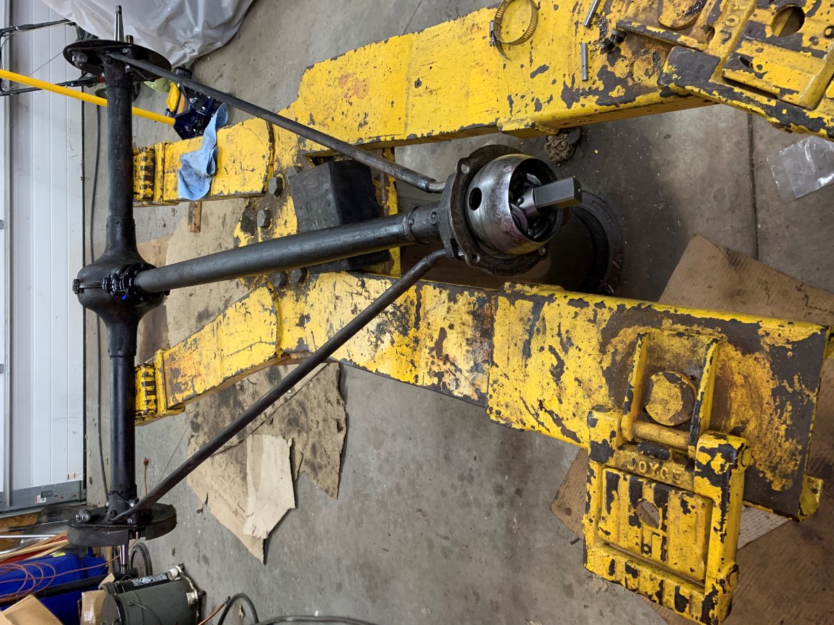

After bolting the axle housings together, I lay the assembly down on two jack stands and bolt on the radius rods and then the drive shaft assembly. It's much easier this way than doing it with the rear axle vertical. Just make sure you are holding the flange that holds the drive shaft in the transmission up around the ball when you attach the drive shaft assembly otherwise you'll have to take it back off again. I've done that a couple of times.
Stephen
Stephen

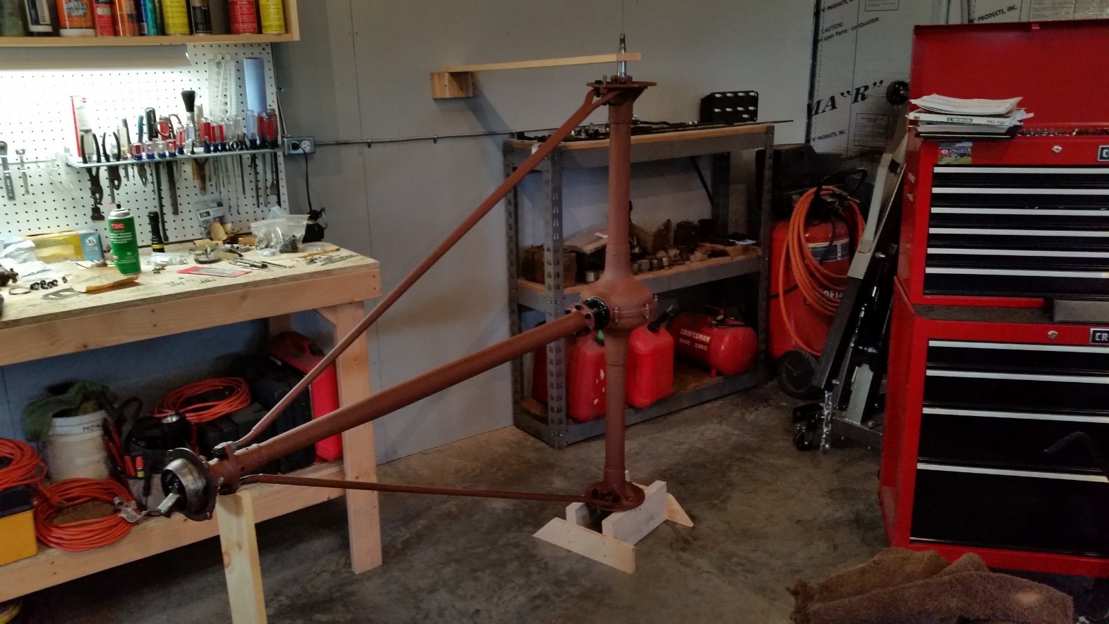

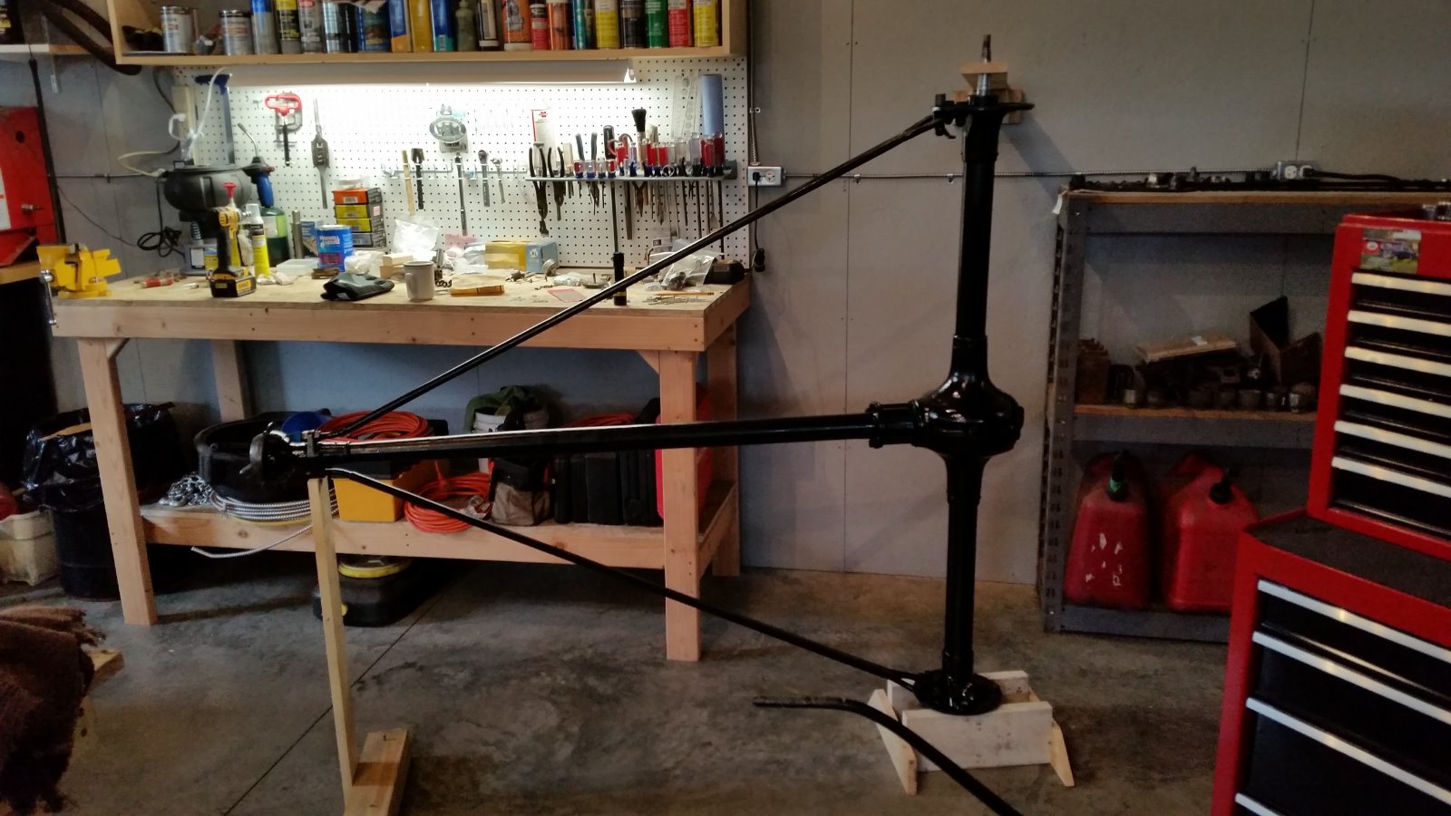

Here's how I did it:

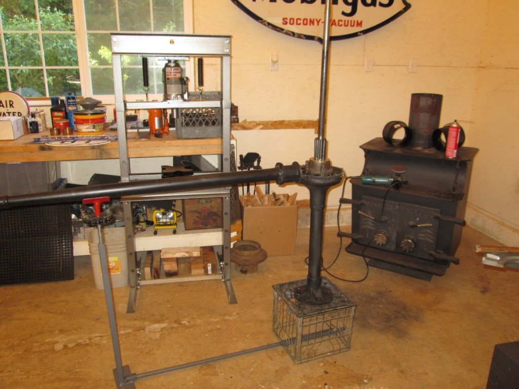

Being slightly "vertically challenged", here's my test assembly station - old steel milk bottle crate, some tubing and an adjustable collar for height to hold the torque tube. I use this for setting the r. & p. then after removing the d.s., assemble the other half on this set-up, remove by engine hoist or similar assisting device & set onto jack stands, re-assemble radius rods & torque tube/d.s. & set on to a rear axle dollie w/wheels to roll back under the T.

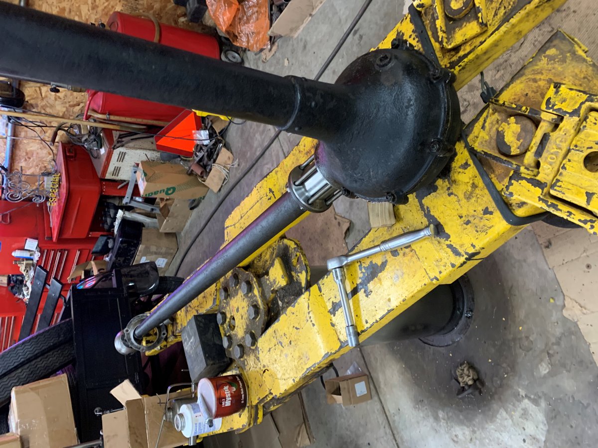

I did two of them this winter on my lift.
