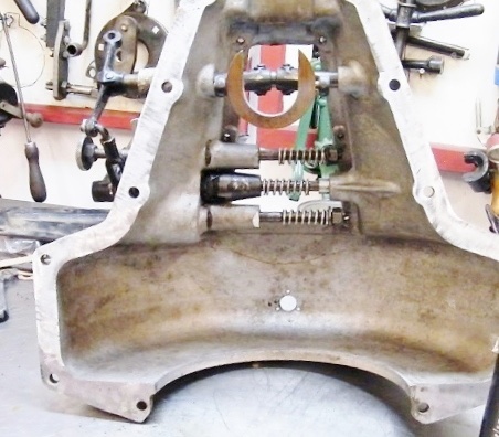

Yes, with non-demountable bands, the hogshead comes off. The pedal shaft and springs stay on, even the nuts and washers for the brake and reverse, only the low speed adj. screw comes out.
That way, easy to put back on, the pedal shafts fall into the band lugs, assuming you wrap twine or wire around them first :shock:
Non-demountable bands and low speed pedal shaft. (1923 engine)

More fun to do if the hogshead is the lighter alum casting!
