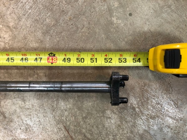

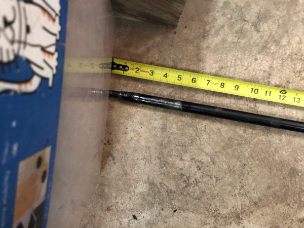

Post by Art Ebeling » Mon Feb 17, 2020 4:47 pm
My late Oct 11 built Touring came with a steering shaft that is 52 inches long from the bottom of the pitman arm threads to the bottom of the top flange. It seems too short making the pitman arm interfere with the engine pan. What length steering shaft should I have? Thanks, Art
Posts: 6743
Re: Steering shaft length
Post by Scott_Conger » Mon Feb 17, 2020 6:45 pm
I'm going to bet that 52 27/32 is what you want.
