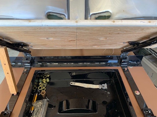

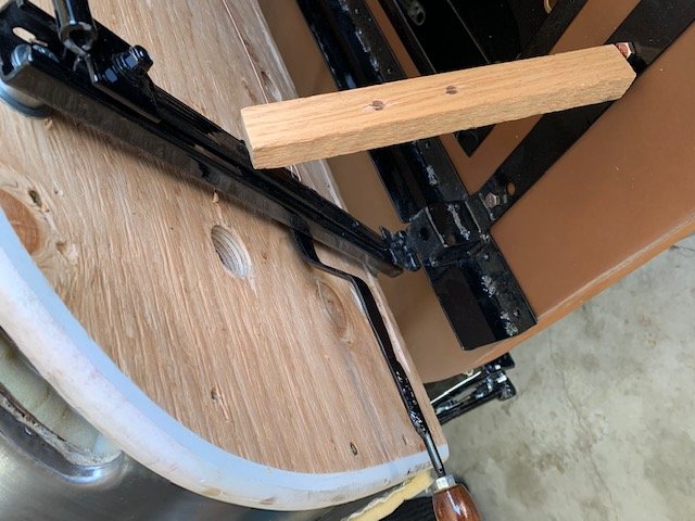

In line with Hank and Frank's comments on ergonomics, I'm building a modified Currier speedster....I am 6'2" - 275lbs and MaryAnn is a slender 5'11", so as you can see, there is a fit issue. The Currier Speedster has a very long hood and that requires lowering the steering column significantly, otherwise the steering wheel will be over your head. Things became even more complicated with the addition of a Vega steering box. At this point I threw up my hands and appealed to Hank Lee for ideas.....he had a solution within minutes. Please see the attached photos. Hank also brought up the idea of ergonomics and suggested tilting the seat back and installing tracks for adjusting the seat position. These tracks came out of a Ford F-150 and were modified the fit the width on my seat. The seat is hinged at the front to allow access to a custom tool box. The last order of business was the modification of a Spencer Fat Man steering wheel as once it was installed the bottom of the rim touched the seat cushion. Hank cut down the spider and had a 14" rim built to replace the 17" rim....et viola! I fit. Also, note the carriage steps...these were attached to a modified running board bracket and use the same frame holes for mounting.
Give me a shout if you have any questions, suggestions or need clarifications.
Apparently I can only attach 5 pictures to a message.....will make a 2nd posting with more photos.
Best
Dave Carnah
Best
Dave Carnah
