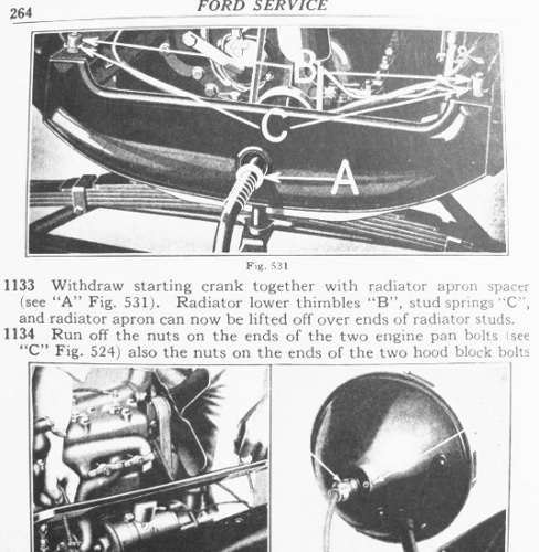

Don’t know if you have one yet but the Model T Ford service manual has a 24-25 Touring car being dissembled. It does have a a pic of the hood blocks ( shelf) being removed. Not a lot of detail but enough of the car is being taken apart to give you an idea of how it would go back together.

If you don't have a manual yet you can view one on Cimorelli's website until you get one. The printed version will have better graphics depending on the publisher. The manual is here.
http://www.cimorelli.com/mtdl/servicemanual/default.htm

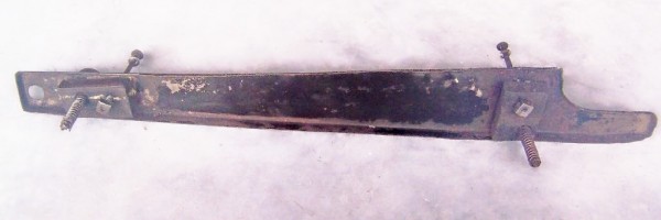

Photos of '23 low cowl hood shelves, with wood blocks installed. You put the assembly together and drop it over the fender which is on the frame rail. Then add the carriage bolts, if using engine splash pans, they secure under the square nuts and lock washer on the ends of the carriage bolts.
A '24 hood shelf is similar.
Mount the springs and hood latches, be sure to use small dia. washers and fold over the cotter pins, as the spring and latch must pass thru frame rail holes and not hang up.
Factory assembly from Service Manual.
