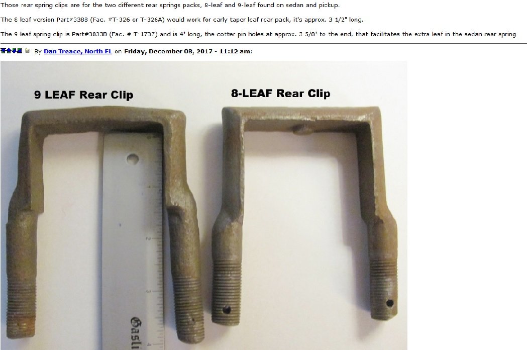

A picture stolen from MTFCA
- Posts: 7312
Re: Rear Spring U-bolts
While the photo Frank posted shows U bolts of different lengths, I believe they have the same application. If you square up the top corners to the same height, the split pin holes are also at the same height, indicating that they are for springs of the same number of leaves. Sure the threads are longer, but to accommodate an extra leaf, the split pin holes need to be 1/4" lower. Perhaps they are in other examples.

that picture is included in the first link I provided. Each part has it's own part #, one for 8 leaf and one for 9 leaf spring, and as measured in the original clearer photo, the distance to the cotter holes are 3 1/2 and 3 5/8 inches, respectively.

I was expecting the flats on the inside of the u-bolts to be longer on 9-leaf spring. Besides leaf count are there other differences?

on a quick analysis, that seems to make sense, but if you look again, you see that the flats go over the frame...the same frame for both 8 or 9 leaf springs...so the flats don't need to "grow" for an additional spring leaf thickness...just the length of the reach, down to the retaining plate.

Today I have been packing my trailer for the Ballarat Swap Meet next weekend. I measured the rear spring U bolts in the trays and found four with split pin holes at 3 and 3/8" and three others at 3 and 3/4", a difference of 3/8". This makes more sense to me than Scott's measurements where the difference is just 1/8", not enough to allow for an extra 1/4" thick spring leaf. Ours are likely Canadian production, but that should make no difference.

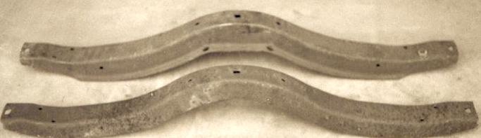

Rear spring clips for the 8 leaf 3 1/2" long clip and 9 leaf 4" long clip (Fordor and Pickup) on the Improved car are the same, except for length and style between the two, they all fit any rear crossmember.
9 leaf:
There are different rear crossmembers, the early Improved car got one similar to the '25 but wider, the later '26 got a revised longer, that has flanges on the crossmember. Those flanges are drilled with holes for the spring clip to pass thru as noted by the crossmember on top in the photo.
If you have a part # on a different clip than the normal 9 leaf clip, please share.
9 leaf:
