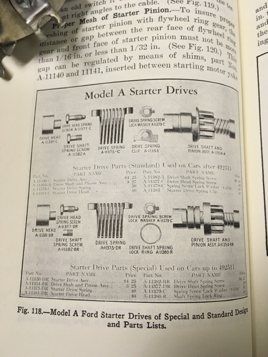

TMiller6
Posts: 331
Joined: Sun Jan 06, 2019 10:11 pm
First Name: Thomas
Last Name: Miller
* REQUIRED* Type and Year of Model Ts owned: 16, 24, 26 Touring - 26 Roadster and Fordor
Location: SE MI
Board Member Since: 2006
Re: Starter bendix springs
Post by TMiller6 » Mon Mar 09, 2020 8:59 pm
Ron,
Your comment about both springs being left hand wound makes me think that the T spring may have been released for service as A-11380-R later in 1928. My car was built approximately 450 units before A492511 on October 1. After that time, the multi-disk flywheel was revised by adding a step to clear the larger diameter Bendix spring that was also used when Ford went to a single disk clutch. For cars built prior to A492511, Ford released a service Bendix drive to replace the Abell drives that proved to be trouble prone.
I have tried using the Model A spring sold by the vendors and found that it hits the flywheel. The T spring does not. In my mind, it would seem logical for the service engineers to use off the shelf parts where available.
My plan is to check this theory at the Benson Ford in time.
Tom Miller
Pep C Strebeck
Posts: 640
Joined: Sun Jan 06, 2019 11:12 am
First Name: Joseph
Last Name: M
Location: MI
Post by Pep C Strebeck » Tue Mar 10, 2020 12:12 am
Ron,
.....makes me think that the T spring may have been released for service as A-11380-R later in 1928. My car was built approximately 450 units before A492511 on October 1. After that time, the multi-disk flywheel was revised by adding a step to clear the larger diameter Bendix spring that was also used when Ford went to a single disk clutch. For cars built prior to A492511, Ford released a service Bendix drive to replace the Abell drives that proved to be trouble prone.
Are you thinking that the Model T Bendix spring was renumbered as A-11380-R, and released for service as part of the A-11350-DR Service Drive for the modified early starters with the 1/2 diameter armature shaft? Part A-11380-R is nothing more than a thin locking ring that keeps the set screw, A-11382-BR from backing out.
As for your issue with the Bendix spring hitting the flywheel; Are you using a Multi-Disc Clutch Flywheel? Is the starter armature 1/2" or 5/8" diameter? If you are using a Multi-Disc Clutch flywheel you need either an original Abell drive starter or an early early/Abell starter that has been modified for the A-11350-DR Service Drive. If using an original 1/2" diameter starter that has been modified for the A-11350-DR Service Drive, the "modern" Bendix springs sold by the vendors is too large in diameter, so is the Model T" spring. You will need to find a Service Drive spring, A-11375-DR. If using a 5/8" diameter armature shaft starter with a Multi-Disc flywheel, it will hit the flywheel.
Model T Bendix spring 1 15/16" diameter T-5022
Model A Bendix spring 2 1/16" diameter A-11375-C
Model A Service Drive Spring 1 13/16" diameter A-11375-DR
TMiller6
Posts: 331
First Name: Thomas
Last Name: Miller
Location: SE MI
Post by TMiller6 » Tue Mar 10, 2020 4:18 am
Pep,
I may need some time to sort this.
I believe my starter is 5/8” shaft. It has the square switch with the cable to the rear but it isn’t Abell. The flywheel is multi disk and not stepped. Gas tank date is 10/5, a Twin Cities build.
Tom Miller
