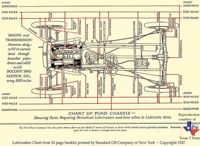

Re: Pedal Shaft Seals
Point well taken. Not indicated on the lube chart.Scott_Conger wrote: ↑Tue Feb 25, 2020 10:06 am..... In either case, you will also want to watch your reverse and brake cams to see if they get any, or enough oil, or have to provide additional lube as necessary during operation.
