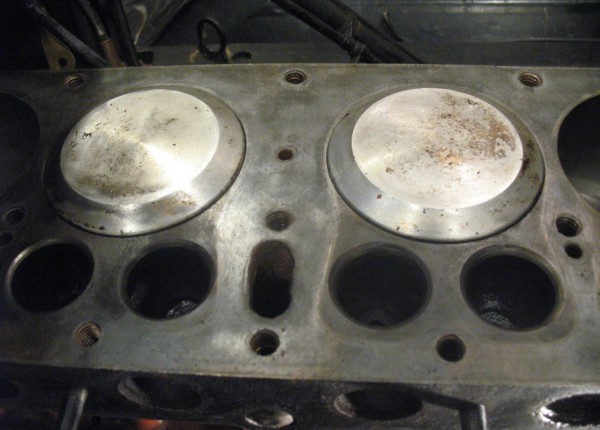

Ted Aschman's article on Murray Fahnestock's valve timing method describes home made tools easily made to substitute for the Wilson tool.  It would be used with original pistons or their modern equivalents, and Aschman provides measurements. But how about these modern pistons?
I don't have any originals for comparison, but I assume these are different. I wonder if anyone can give measurements for the Wilson substitutes that will work with them.

I've done it with factory grind cams.  I wouldn't bother with a cam of new manufacture where the manufacture dictates it was ground to be set by lash.
As to measurements -- depth mics and indicators don't care what pistons one has.
