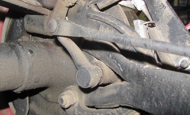

Yes the large brake drum '26-'27 rods are shorter and straight because the longer brake lever at the larger backing plate is farther forward than on the small drum ('25 and earlier) shorter lever backing plate.
