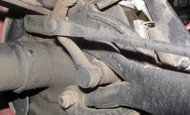

Thank you. Now that I knew what to look for, I located a set of straight ones. They seem to be one inch shorter. Is that correct? It will make it a lot easier to adjust my rear brakes !
Posts: 4090
Re: Brake Rods
Post by DanTreace » Wed Feb 26, 2020 8:32 pm
Yes the large brake drum '26-'27 rods are shorter and straight because the longer brake lever at the larger backing plate is farther forward than on the small drum ('25 and earlier) shorter lever backing plate.
