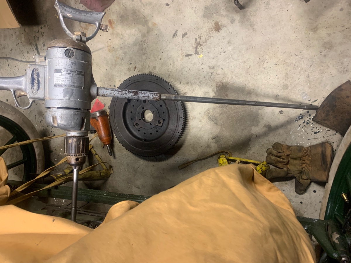

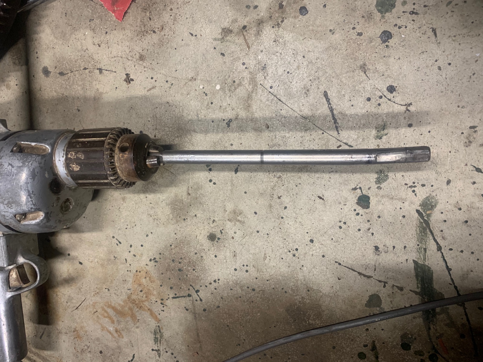

Those who have been following my restoration of the 1909 touring may remember that I built the engine over two years ago and I started it by temporary installing a later flywheel and hogs head. It ran for a few minutes then I shut it down. The engine has been sat now for close to 24 months and now I was unable to hand crank. I have skinny arms and I was reluctant to ask friends, most of whom have bad backs. I seriously thought of towing behind the truck but I was worried that I would ruin my white tires in the attempt.
So my friends and I have been looking into other options. Eventually we came up with a system that looks promising.

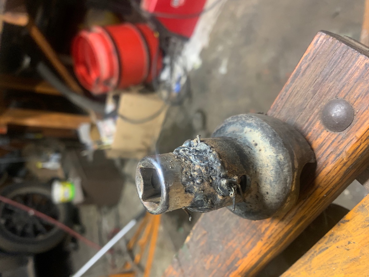

I removed the original crank and used a half inch socket welded into an old ratchet. Then I modified an length of hard steel with a square half inch at one end and ground flats at 120 degrees at the other end. For power we started with a large powered impact driver. It failed. Then I tried my 1/2” drill. It failed. Then I borrowed a huge 3/4” wrench and success. The torque is considerable so I used a 36” extension. My first effort threw me across the shop, luckily with no damage except to my pride. So there we are, we can now turn the motor. Next is to remove all the covers, add some gas & coolant, install spark plugs and give it a serious try.

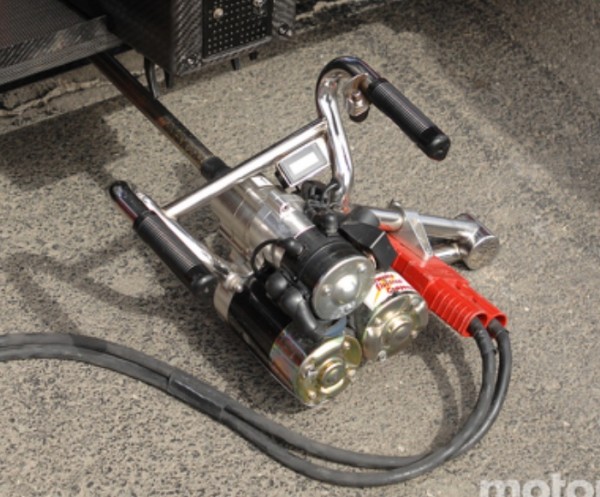

Need something like this :
But must make sure you have a positive DIS-engagement of the crank when you release the trigger. Unfortunately the T crank doesn’t really give you that, hence the kick back many incur. I’d at least clean all rust off the engagement fitting and crank end, and grease it, so it disengages easier. And keep track of the fitting so it doesn’t fly out on a kickback or a start.
Also be careful of those old high torque drills, as they continue to turn after releasing the trigger. I have one of those, and would not use it for this purpose. About 40 years ago, it almost broke my wrist, or arm, as it stalled while drilling, and I got tied up by the cord before it stopped spinning. Ugly.
You should only need one or two revolutions at a time to get an engine to fire. A drill will turn many more than that when you just pull and release the trigger.

Tony - I can't help but think that perhaps the easiest and safest solution to make hand crank Model T engine starting easier (less physical exertion) would be to merely add an extension to the standard model T hand crank. After all,....the 40 hp Model A could be as easily hand-cranked to start as the 20 hp Model T, and that was Fords solution. They just added a bit of additional length to the hand crank so as to afford a fit of extra leverage!
In your case, why not just add even a bit more length to a hand crank for additional leverage? Only thing is that it would be even MORE important to guard against "kick-back" as a kick-back would be even more dangerous. Just a thought FWIW,.....harold

I'm afraid that the drill may still turn too fast. Even if it is slow enough, I would not use it to start the engine. I think you should leave the spark plugs out and use the drill to "run it in" until it turns easy enough to hand crank it. You definitely do not want to have it start and not properly release from the crank. That could be disastrous to you, the car, your shop, or all three! Also if it does release and the socket/claw comes off of the extension, it could be thrown into the fan or radiator.

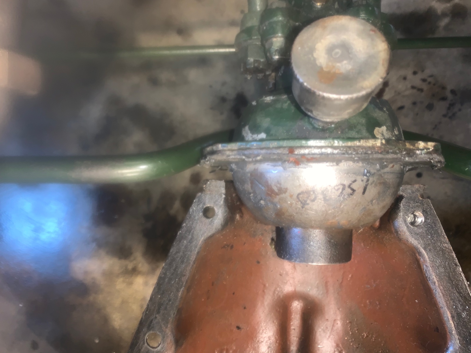

PROGRESS
Now I’m back from the Death Valley tour, I made a start on finding why the 09 is so hard to crank.
I have carefully removed bolts until I could move the motor free of the universal joint and hey presto I can now crank the motor. Of course it’s still a little tight but that is expected of an engine that has run less than a mile. Later in the week I’ll use the sky hook to take it out of the car then I’ll see if I can get to the clutch without removing the pan.
One concern is why it didn’t loosen up when I jacked up the back wheels. Maybe the back axle is tight. That will need investigation. Most complex problems are two (or more) simple problems.

This sure is a puzzle.
Norm may have hit on something close to the problem, except the UJ is not too long but too short.
Let’s back up. The engine is out and it turns quite freely. The front and support holes in the pan all lineup with the chassis. Just to make sure I tried a spare pan and it too lines up with the chassis holes. So it seems the problem is not in the motor of transmission.
However I noticed last night while the spare pan was in the chassis the nose of the axle is not in line with the rear of the pan. Remember this is a early pan and is very flexible. It appears when the driveshaft is connected it distorts the pan cause it the fourth main out of alignment and subsequent hard cranking.
Next I will investigate why the drive shaft is not lining up correctly with the pan. Later I will add pictures as this is something new to me.
Could it be caused by a defective or damaged rear spring.?
Any ideas are welcome.

Re: Cranking an early hand crank T
I slide the fourth main in and out with no binding.
I measured from the rear pan bolts to the chasssis on each side and they are equal.
Below are the pictures of the distance between the back of the pan and the fourth main when in contact with the plate on the torque tube. That distance measure 3/8” on both sides.
I believe when I tighten the four bolts on the fourth bearing, the pan is being pulled down, remember the torque tube is at an angle, and distorting the pan.
This was confirmed when I removed the cap at the front of the pan, it rose up about 1/2”,Including all the weight of the motor, probably due to the force generated when the gap is closed.
Next I will compare the axle placement on the 09 to the 14 touring and see what it uncovers. Right now I suspect the back spring is the culprit.....
