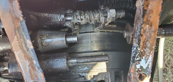

Towards the end of the season last year I had to adjust the low pedal band several times had a feeling something was up.
Found this at 10 o'clock this morning

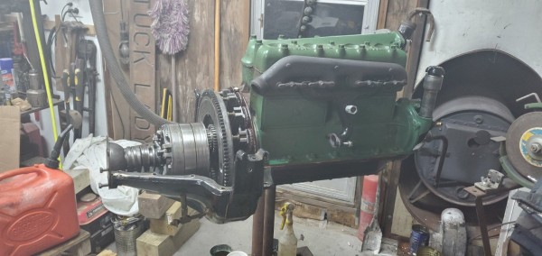

Motor out for o'clock this afternoon
Will post more as I progress.

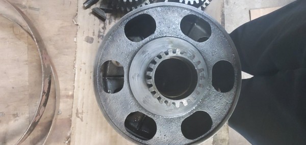

OK Kevlar, For the last 7 or 8000 miles Since rebuild. It was my 1st transmission rebuilt I did Not have it Magnifluxed But did clean up look it over and then do the thinner test looking for cracks. Could have missed them Before they grew or could have caused them.
Not one crack but two

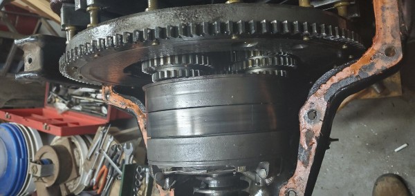

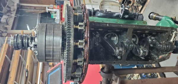

Almost 12 Hours after Discovering the cracks have it ready to pull transmission apart. Will have to wait for another day.
Ready to pull transmission apart

I doubt seriously you missed both of those cracks when you rebuilt it.Something happened in that 7000 miles probably
Just looking and thinking,you wouldn't need to remove the trans from the engine to replace the drums would you?

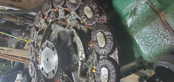

Lots of fuzz to clean out. Be sure your engine oil line is clear.

It gets in everything, can block the oil holes in the mains and even get all tangled up in the oil rings.

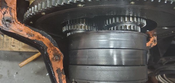

The bluish color of the drum is a key that the band has been dragging. This is usually caused by a worn notch and cam on the low pedal shaft. This is what happens. You have to tighten the low band too tight in order to get the band to lock before the pedal hits the floor board. So the band drags all the time you are in neutral, high, or reverse. It only stops dragging when the band is tight in low gear. That continual drag overheats the drum which gives it the blue color. eventually the drum cracks. So even if you replace all the drums and get new bands you will still have the same problem until you replace the notch and cam. I know this from experience after breaking two drums on the same car. I have not had that problem since I replaced the shaft, cam and notch.

On the top picture looks how worn smooth the low speed drum is..maybe indicating a significant drag ?

The color of the drum in the photo is misleading it is Not blue Just shinier than the rest because it gets the most use, reverse Drum not so much brake drum not at all. When I got the car it had Rocky Mountain brakes installed and the Ford transmission brake was not used. I know there is opinions pro and con to this practice But so far it's worked out well. When I rebuilt the motor and transmission I left it that way the only thing I changed was putting lined emergency Brake shoes on So that when stopped Uphill it would still hold. Can't always count on those rocky's holding backwards. Cam and notch Where replaced when I rebuilt it and still look fine whenever I adjusted the band I always made sure that I had a free neutral If the band was too tight I would not be able to roll the car back-and-forth by hand due band drag, I think would someone please correct me if I'm wrong on that point. In the warmer months I use the car pretty regularly and I am thinking Due to too much slippage When I put the car away, I keep it in a cargo trailer sometimes I probably slipped the low band too much going up the ramp.

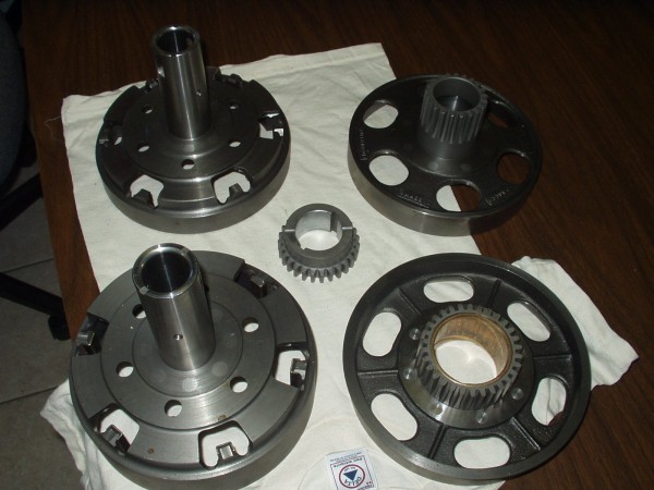

The Low speed and reverse are the same throughout the Model T years.
Your pictoral example is the reason why we started making and selling drums.

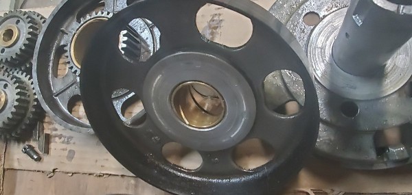

Norman you are absolutely right and I was wrong My apologies. Here are some photos it got hot at some point I'm thinking probably Slipping it when I'm going up into my trailer. Here are a few pictures
Two cracks 1 at 12 o'clock 1 out about 3:30
It got hot
It got hot
Lots of goo funnell was amazingly clean but havn't blown the tube yet

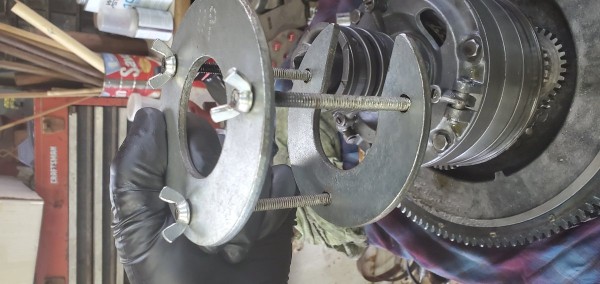

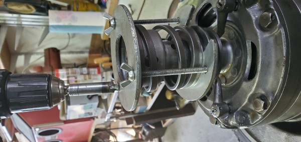

Put together some decent drums with no cracks, new Bushings where needed cleaned up the gunk putting her back together.
Compressing Spring
Compressing Spring
Spring compressor
Spring compressor
Transmission back together just need to wire Drive plate bolts
Going back together
Going back together
