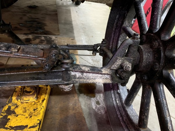

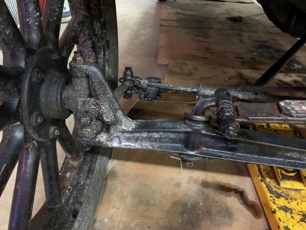

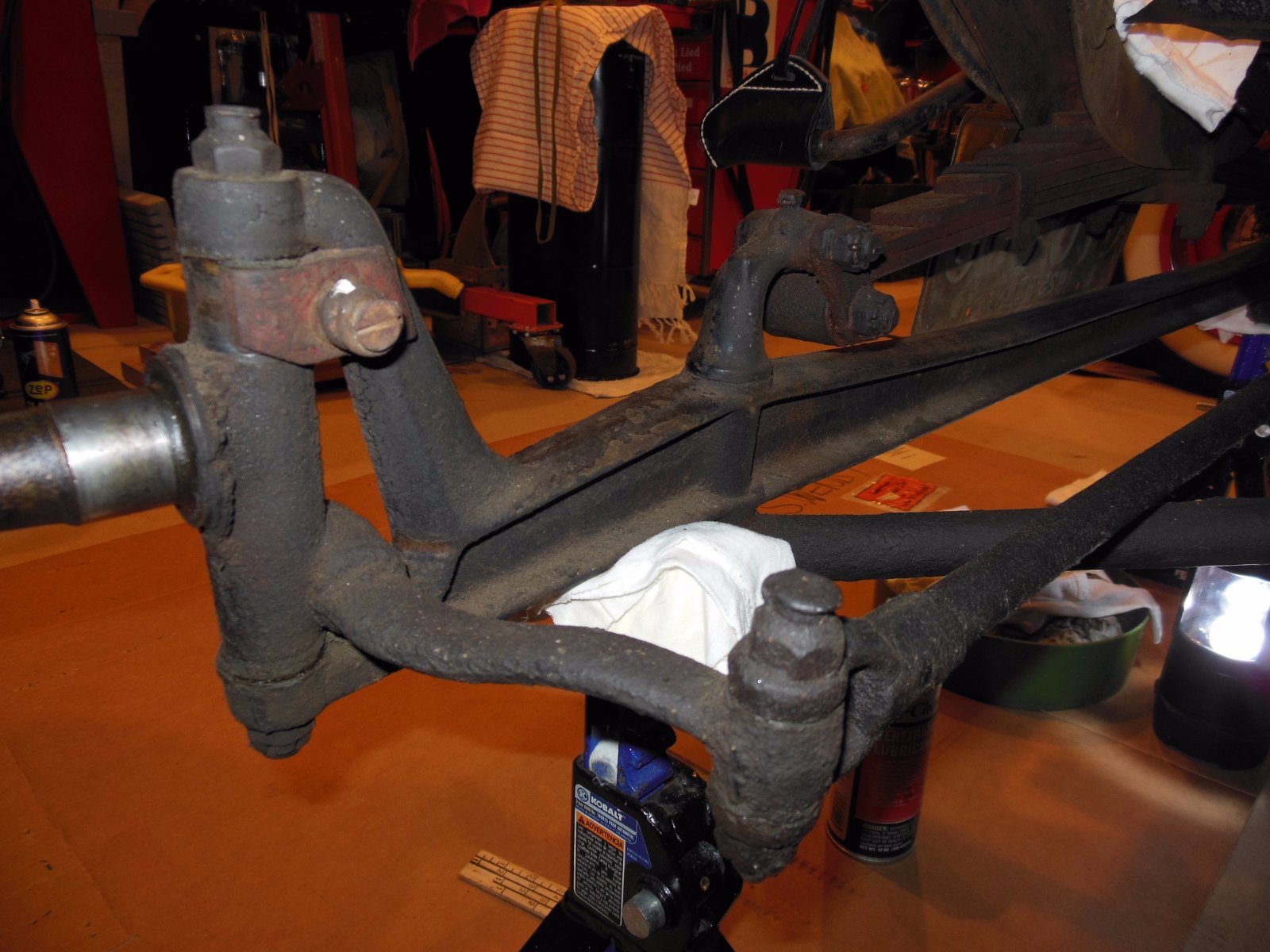

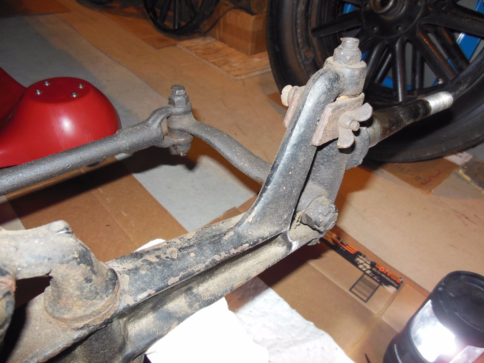

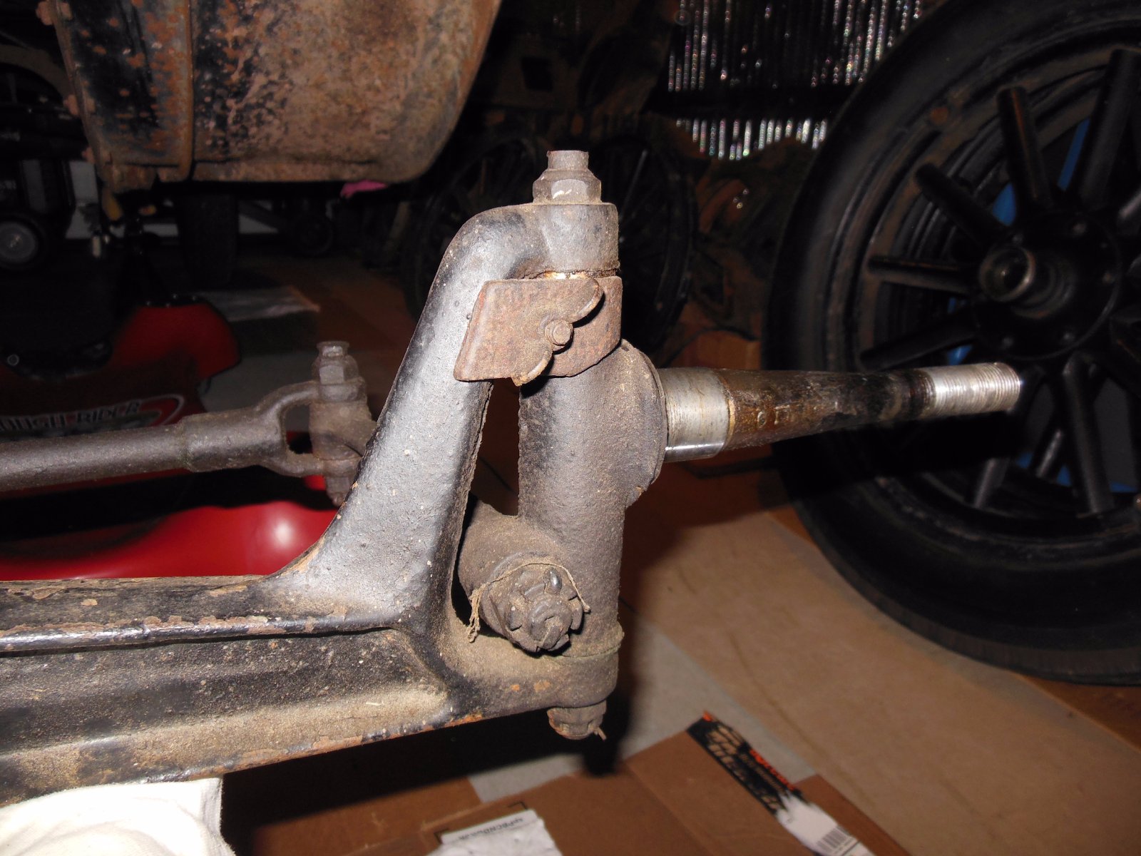

Here are several pictures of these attachments on the upper spindle body when I was rebuilding the front axle parts, the last two are off the vehicle with some stamped info.
Was wondering they are and their purpose back in the day, any input would be great. Thanks

Accessory "anti-shimmy" device - purpose was to minimize or eliminate "The Watussi".

Thank you for the posting. Always another T accessory to learn about. I had a 12 torpedo roadster that would have benefited from these!
