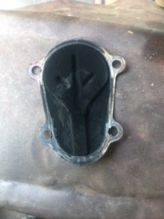

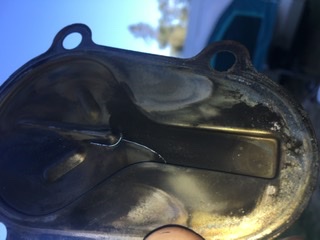

William, I just replaced my heating plate on my ‘27... again. The new ones do look shiny like stainless. Stainless would be a good choice like the tube running through the stove. The problem I have with the reproduction heating plates is that the detailed stamping is too sharply delineated.
Shiny steel stamping with evidence of use
The plates tend to crack at the stamped feature.
Crack follows stamping then spreads from there.
I assume that these cracks are a result of the reproduction stamping dies being too sharp. Although this crack looks small it will expand when hot. Even a little exhaust gas puffing into the carburetor mixture will make the car run poorly if at all.

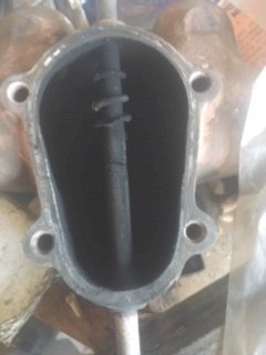

While you have the carburetor open be sure to check the riser tube. looking closely at this one you can see it was cracked through the center below the heat exchanger wire coil. It is interesting that the plate and the tube failed at the same location... don't know which is the chicken and which the egg!
crack in mixture tube below the coiled heat sink wire
