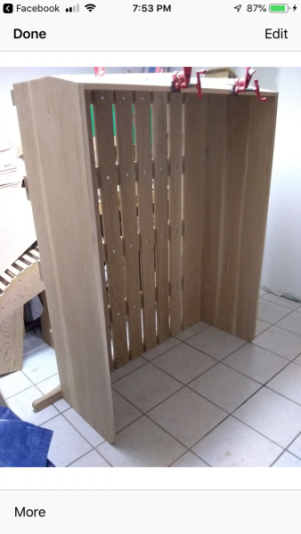

I am building a 15 model T based ALF fire truck and the bed is made of white oak. I was told today that white oak is difficult to get paint to adhere too. Any truth to this? Any one have experience painting white oak?This is a picture of the hose bed on it end. Thanks!
Posts: 2060
First Name: Jeff
Last Name: Humble
Location: Charlevoix, Mi
Board Member Since: 2006
Re: White oak bed
Post by Humblej » Mon Mar 16, 2020 7:08 pm
It should take paint fine. Start with a good primer.

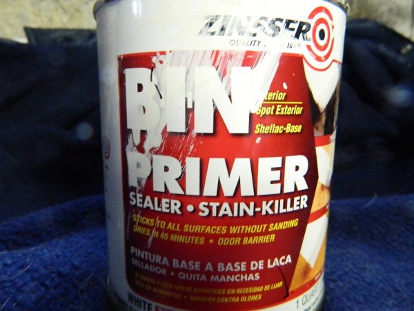

BIN....???
Am I the only dummy that needs to read whole words? I HATE acronyms!
TFan
Posts: 408
First Name: Jim
Last Name: Riedy
Location: Sandusky,Ohio
Re: White oak bed
Post by TFan » Tue Mar 17, 2020 9:58 am
I believe this is what they speak of. Jim
