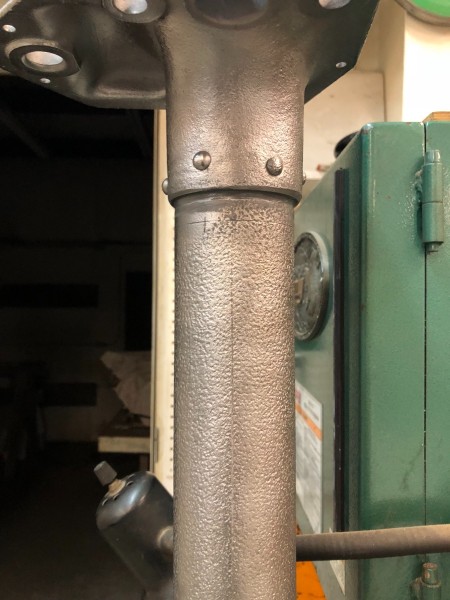

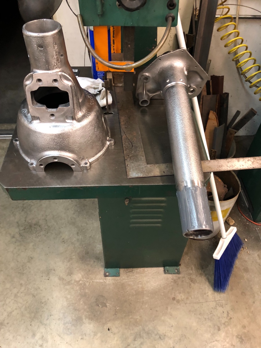

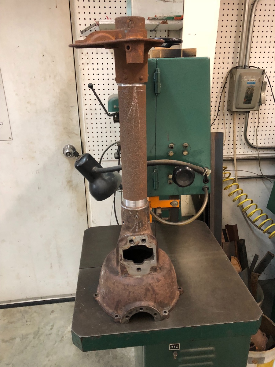

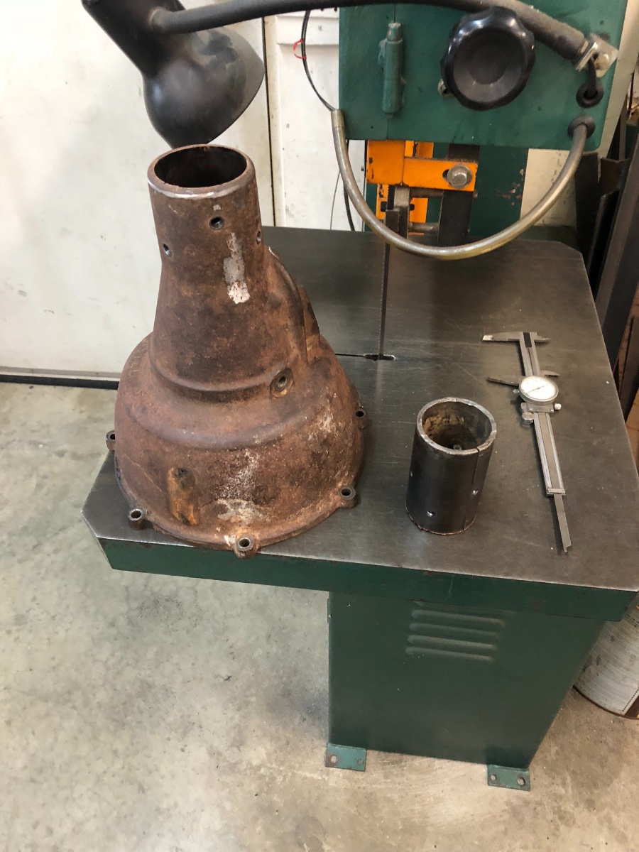

Post by Henry K. Lee » Wed Mar 18, 2020 8:48 pm
Posts: 5603
First Name: Henry
Last Name: Lee
Location: South Pittsburg, TN
Re: Intalling axle tube in Ruckstell?
Post by Henry K. Lee » Wed Mar 18, 2020 8:50 pm

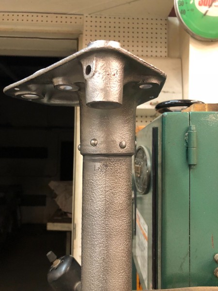

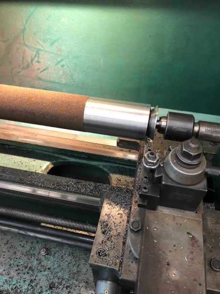

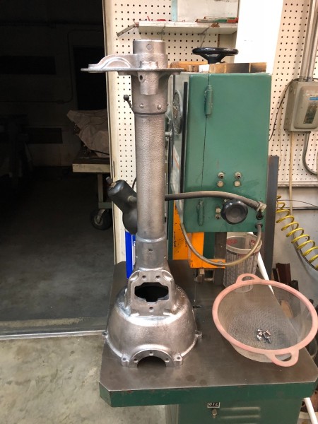

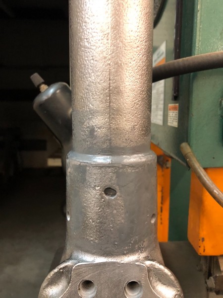

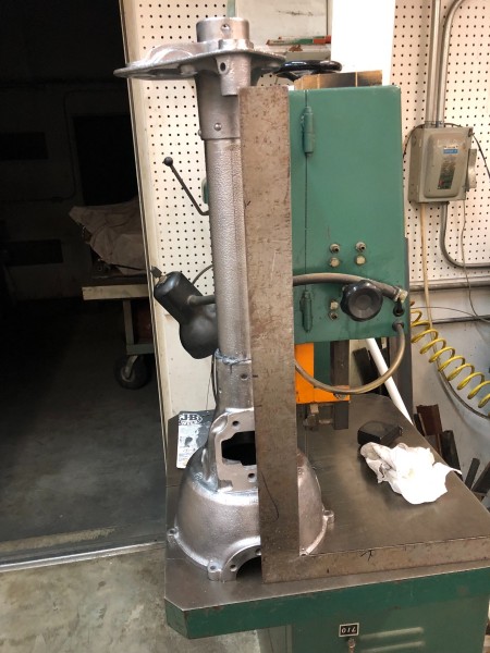

Posts: 5603
First Name: Henry
Last Name: Lee
Post by Henry K. Lee » Wed Mar 18, 2020 9:38 pm
Les, I set mine with about a .0015 clearance, JB Weld reduced with acetone, nice coat then it presses in with a mallet impact to set the length on the money. Let set overnight, drill and tap 1/4" X 20 grade 5 Phillips head machine screws with epoxy on the threads, after installation, fill heads with epoxy. Works excellent.
Hank

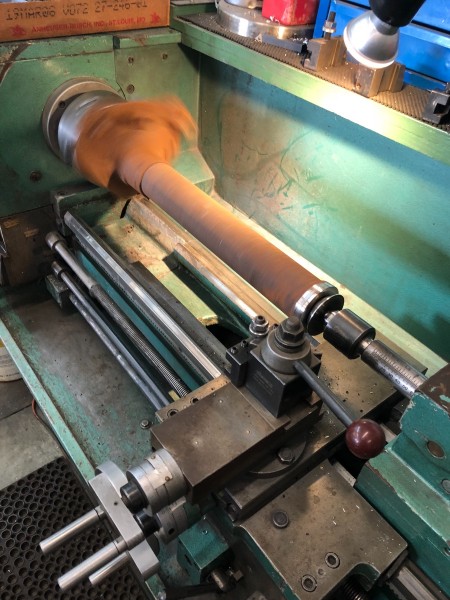

Posts: 5603
First Name: Henry
Last Name: Lee
Post by Henry K. Lee » Thu Mar 19, 2020 1:09 pm
Since the donor tube needs to be machined to fit the Ruckstell housing anyway, centering from the brake cam shaft well. I use my tool post on the lathe and go in and out as required following a linear path on axis. That is what the scribe mark is in the photos. Overall length from flat plain of housing to the very outmost of the end of tube at seal end is 26 7/8”.
