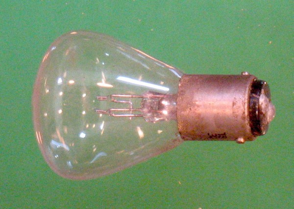

You have the wrong bulb. The correct magneto headlight bulb will only have continuity across the two contacts on the base.

I suspect that you either have the wrong bulb or a bad socket. A standard 6V or 12V bulb grounds the filaments through the base. A magneto bulb is not grounded through the base, the filament is connected to the two contacts only. Old sockets often have had the little springs between the thimble contacts and the bulb contacts overheated and may have lost their "spring" and may be touching the side of the socket and grounding.

What you are describing is exactly what happens when you put a battery type headlight bulb into a magneto wired socket. If you have an ohmmeter, you will find continuity between either solder button on the bottom and the brass shell of the bulb.
When the sockets are out of the car, the current goes through one filament of the right hand bulb. Finding no ground, then it goes through the other filament through the radiator jumper wire to the other correct magneto bulb.
When you put the sockets back in the car, you satisfy the right hand ground and the left bulb which has more resistance than the ground fails to light.
As in post #1, I maintain you have the wrong bulb.

I suspect that the bulbs you have gotten are still not the right ones. The proper magneto bulbs for for the model T MUST have two pin contacts! And neither contact can have continuity to the base. They should NOT have two filaments, but that is possible (depending on how the bulb is wired internally). Check that. Common type (available in several voltage ranges) two contact pins with two filament bulbs will ground both filaments through the bulb base. I would not be surprised if the bulb suppliers have substituted the wrong bulbs because they are marketing, not engineering. (Used to run into that problem at work a LOT!)
I can't be sure without running some tests up close and personal? But what I suspect may be happening.
You have two filament bulbs grounding through the base. When the sockets are in the lamps, the first bulb grounds the first filament through the base. It lights, one filament (you probably can't see that because it is bright and can hurt the eyes), and grounds out through the base and lamp. That grounding in effect shorts the circuit, causing the second lamp to not work.
When you remove the sockets from the lamp, the base isn't grounded now. What happens is that the current flows into the first socket, through one pin connector, through one filament into the base which is now NOT grounded. So the current then flows back from the base through the second filament and on out though the second pin connector. From there to the other socket with the other bulb. If you connect your test ground to the base of the socket. it will take the power in through the first pin connector into the first filament and light it up before heading out through the base ground. If you connect (or keep connected) the second lamp to ground from one of the pin connectors as original wiring dictates? Then the power would again double back through the bulb through the second filament and light both filaments before exiting out through the second pin connector to ground.

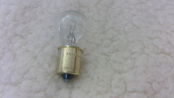

I feel really stupid. I bought two sets of bulbs from Lang's. One set magneto and one set 12V. They arrived unmarked. I assumed the ones with the double filaments were the magneto bulbs as they were most similar to my current magneto bulbs. I was wrong, and all of you that stated I had the incorrect bulbs were absolutely correct. I switched to the other set of bulbs and everything worked properly. Thanks to all of you that responded, I will listen more intently from now on.

I ran bulb #1009 for 30 years, many times driving across the San Francisco Oakland Bay bridge, dark going both ways. Plenty of light above 20 MPH. I tried a couple of other bulbs before I found the 1009s and they would burn out at speed the 1009s never burnt out in 30 years of occasional use.
