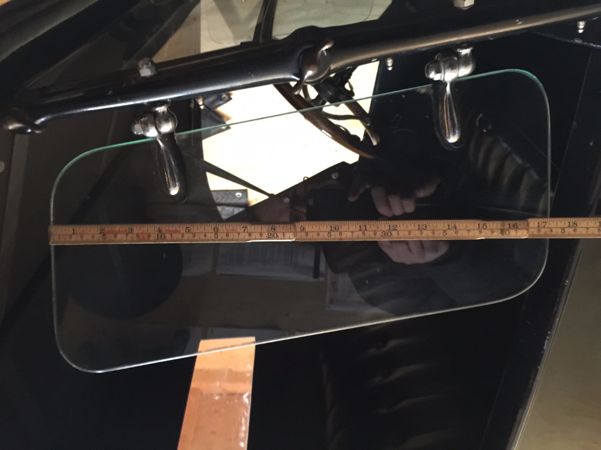

Re: Wind wings
Hi. Took some pictures of my 26 roadster. Seems the sides are parallel sideways and up-down. 200mm X 440mm.
