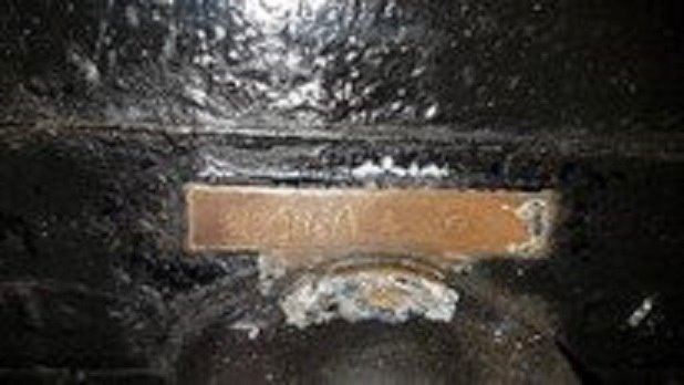

Hi Folks,
This is my first forum post. My name is Brian and I just imported a beautiful 1913 model T into the UK.
The number on the engine plate is 261644 which fits in with the age for May 1913, but unfortunately when I tried to register the car in the UK, our highways department called DVLA, sent out an inspector to see if the car was real. Therein starts the problem. The engine plate is stamped 261644 but about I/2 an inch to the right there is a no 9 stamped. The stamp is slightly out of line with the main stamp but the inspector insisted it is part of the number and recorded it as 2616449. The California Title document only has the first 261644 so now the DVLA will not make a UK title unless I can prove the car is 1913 and explain the extra number.
Can anyone help?

Sorry to say, there is not much 1913 there. Like others, I cannot see enough detail in the low resolution image of the serial number. However, I do know the series of changes in the shape of the serial number embossment to know the block is not any earlier than 1917. More likely, even much later. Does the front of the motor, on the other side, have mountings for a generator? Those mounting flat areas and bolt holes were added in 1919, whereas all the earlier blocks had a cast-en-block cover around the side and back of the timing gear. Again, photos of the other side would help there.
What I can see in the serial number photo suggests that the serial number on the block may well be one stamped on after the block left the factory. The block was probably a replacement for a damaged block many years ago. Does it have a single long cover over the sides of the valves? Or two short covers?
More and higher resolution pictures of the engine and car can help us to identify what you have.

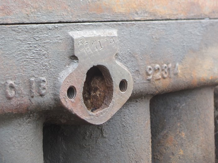

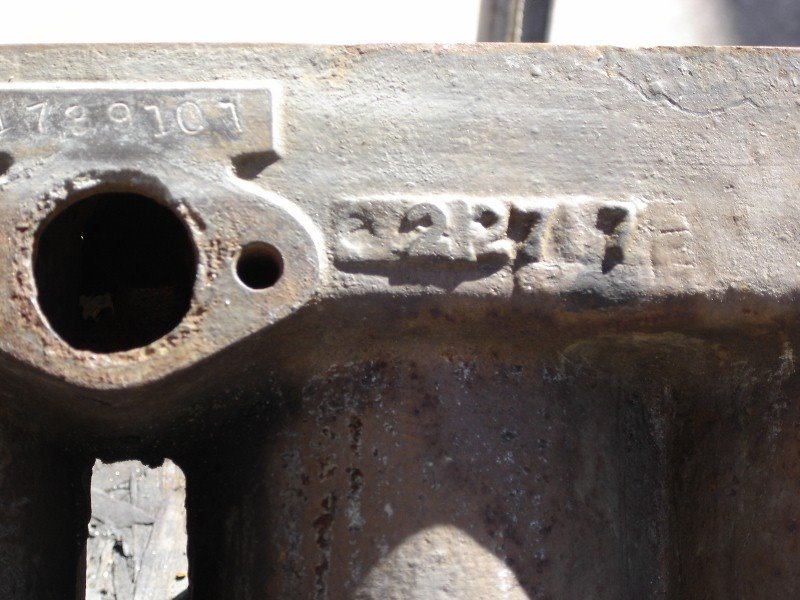

Nice T! Like the speedster look. As Wayne noted the serial # boss on the block grew in size over the years, an early block would have a much smaller length boss, below is a 1914 serial number on a 1914 genuine block.

And a later block compared to your photo, enlarged slightly.

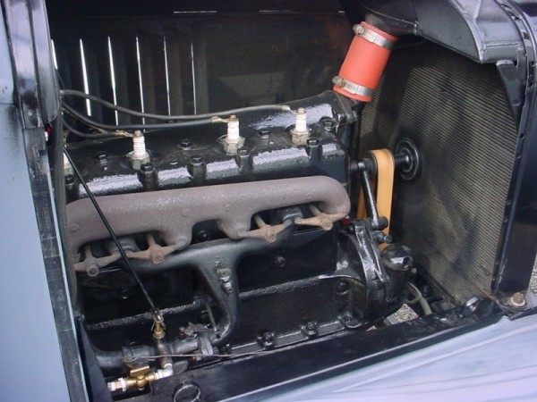

Allan you are right, this photo of the right hand side of an early engine would be very similar to what he should have with that serial number. It is what I could find that had two valve covers and no generator mount. Yes carb, manifold radiator etc is wrong. It sure sounds like it is NOT a 13. Thanks.
