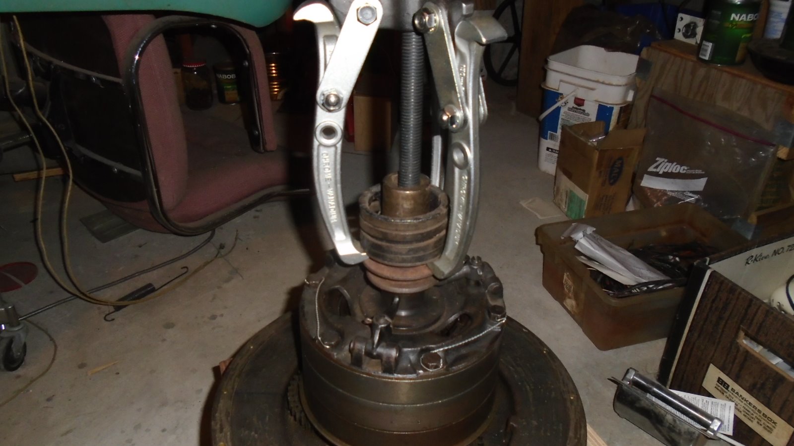

Now after all the bodywork and other items are completed, time to crank the motor. It was very very stiff. After a few false efforts, mainly the timing being off 180 degrees we towed it and in less than 100 yards it was running.
After the usual mixture and timing adjustments it seemed to run well. However after I stalled it in reverse, we still couldn’t crank it. So we towed it again and I drive it home to the barn where it stalled again in low band.
So the motor runs but there is still lots of friction. I decided the transmission is faulty. So I removed the hogs head, all three bands and the three clutch adjustment screws. Now the engine rotated fairly well but when I turn the rear wheels all three drums rotate. They rotate a different speeds.
This seems wrong to me. I would expect the brake drum to rotate but surely the other two should be stationary. When I hold either reverse or low drum, the back wheel lock up.
Any idea what’s wrong with my transmission?

Not wrong, turning the rear wheel drives the brake drum drive plate so all drums will rotate through the triple gears and slip at the clutch plates.
- Posts: 1455
- Last Name: van Ekeren
Re: Hard crank on my 1909 touring.

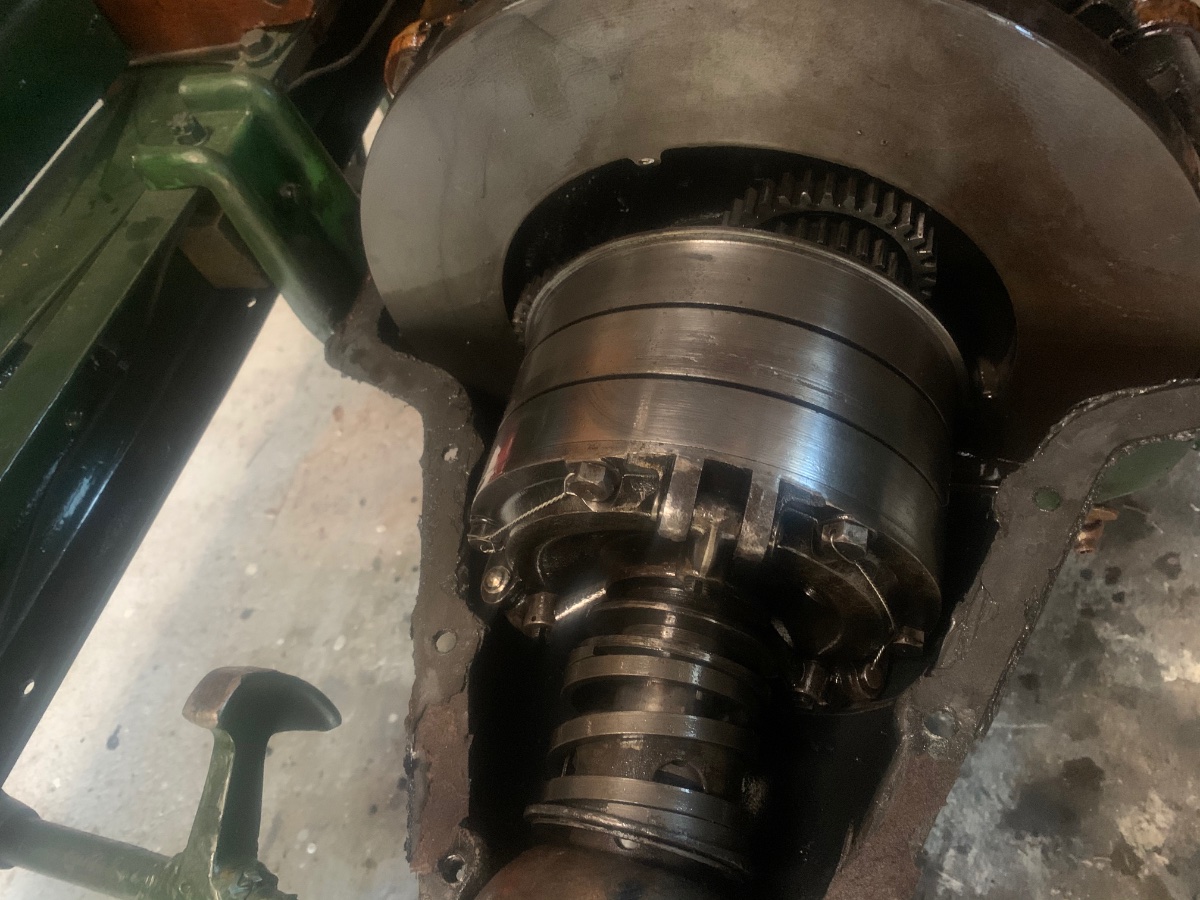

After blowing up your photo I see your problem, the clutch fingers are not adjusted correctly, the cotter pins are missing and the screws are backed out. The clutch is dragging so you can't crank.

I was wrong in thinking only the brake drum should turn, after reading the MTFCA transmission book they are operating correctly.
So either the bands were hanging, or the Clutch was not releasing. Being an early hogs head with the small square hole it’s tough to see and measure. Also I guess the plates could be hanging.
I’ll put the hogs head back on with no bands and no screws. So there should be no pressure on the clutch and no band friction
I rather suspect the clutch plates are catching

- Posts: 365
- Joined: Thu Jan 17, 2019 11:52 am
- First Name: David
- Last Name: Menzies
- * REQUIRED* Type and Year of Model Ts owned: 1926 Touring and 1915 Touring both Canadian models
- Location: British Columbia
- Board Member Since: 2012
( I don't know why the first photo is duplicated.)

David, I looked closely at your photos and it appears that the 3 dowel pins on your clutch push ring that come thru the driving plate cover are sticking out a bit too far. Normally, on most Model T’s, when you remove the 3 adjustment screws, the ends of the arms will bottom out on the flange of the driving plate shaft and there will be slight clearance between the arms and the push ring dowel pins, thus fully releasing the clutch. This is not happening on your transmission. It may or may not be something that requires repair. I can think of few reasons this could be occurring, but in most cases if your transmission is running and driving okay there probably isn’t anything that would really require immediate repair.

This transmission was assembled with 13 small thrust plates and 13 large thrust plates plus a distance plate as per the 1915 parts book. I know some later units have only 12 small, 13 large and no distance plate. With one less small clutch plate and no distance plate would allow a greater distance for the fingers to travel and would probably allow the clearance you are talking about. This 1915 transmission is an original and is assembled as per the 1915 parts manual. I had a lengthily discussion with a reputable transmission re-builder as to the number of plates in a 1915 transmission and he was of the opinion that it had 13 large and 12 small and no distance plate as this was the way he had always assembled them. I brought his attention to the 1915 parts book and he was not aware that it was 13,13 and a distance plate. I went to a swap meet at Bakersfield and a vendor was selling transmission parts by the 5 gallon pails full and there was a pail full of clutch discs I asked the vendor if he had a distance plate for a 15 and transmission and he had never heard of the part. I started digging through the 500-600 discs and fortunately I found the only distance plate he had, and he said he had never seen one.
I saw some photos of a newly assembled 1915 transmission and when assembled the tops of the finger adjusting screws were near the bottom of the slots therefore only allowing about one turn of residual adjustment. This appeared somewhat incorrect to me, I contacted the assembler and questioned the assembly and I was informed that he had been doing this for 40 years and he was sure it was correct.
I further persevered with my inquirey to his frustration until he examined a non molested transmission and found it to have 13 small, 13 large and a distance plate with the adjustment screws well above the tops of the fingers.
With this configuration the only way to release the clutch pressure is to compress the spring. With the 12 - 13 disc arrangement less the distance plate I would agree that removing the adjusting screws would release the pressure on the discs. I have a 1926 transmission and there is no pressure on the discs when the adjusting screws are relaxed, however not so on the 15.
In Chaffins parts book it shows part nos 3328/29 clutch disc set, original, steel (09 27) (25 piece).
They are not the same from 09 - 27 and there is no mention of the distance plate, part no. (3330) and there are 27 pieces up to about 1917 and 25 pieces in later units.

I phoned Tony a few days ago and it definitely sounds like a transmission issue. If it isn’t band interference, then it is an issue with the clutch plates (number and/or thickness and/or style and/or disc drum and spacers). The trans parts may be original’09 or at the outside ‘13 or earlier. If it isn’t one of those simple things, my next guess is that it may be a fractured driven gear sleeve. That is more of a “usual” problem on ‘26-‘27’s, but not unheard of on earlier cars. My impression is that Tony is a good T mechanic. I’m sure he will post here when he finds the issue. Should be interesting.
Topic author - Posts: 663
- First Name: Tony
- Last Name: Bowker
- Location: La Mesa, CA
In describing the problem to some friends we found this picture of the brake drum of the 09 during assembly.
As you can see the lugs are in excellent condition so the plates are not hanging on them. However the lugs do not reach the back of the drum so it does require the thick drum. I honestly cannot remember if I did indeed use a thick plate........

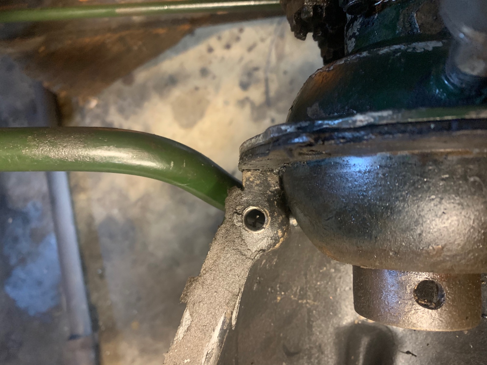

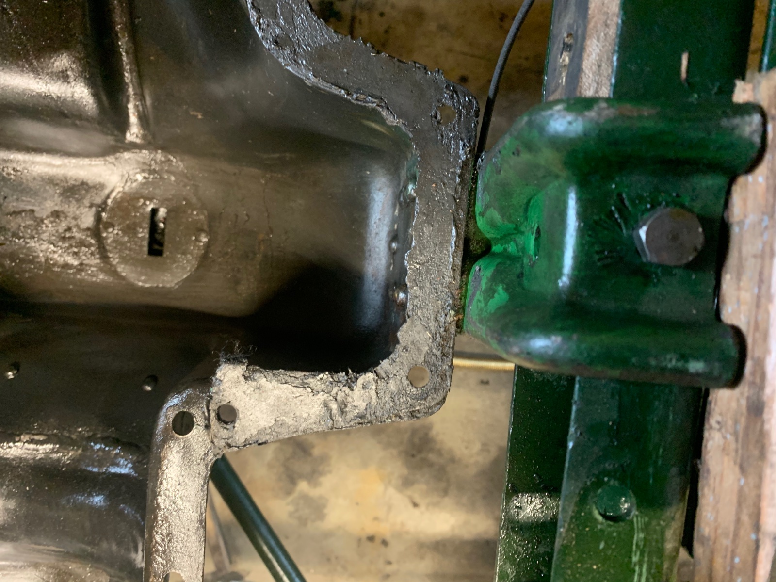

- First Name: Tony
- Last Name: Bowker
Well after a couple of weeks poking around I believe I have located the problem.
In the course of the work I removed the motor, more later. While it was out I replaced the hogs head and flywheel with a starter version and ran the motor. It turned fine and after a little adjustment of the five ball carb it runs well. I also checked the transmission and clutch, both are just fine.
Now back to removing the motor. When I loosened the front two bolts, after the initial tightness I can usually remove the screws with my fingers. Not this time. As I loosened the bolts, the bridge kept rising keeping pressure on the bolts. Odd. So I pushed the motor down and removed the screws and let go of the motor. The nose rose up about three inches. Yes I’ve never seen this before and most of you doubt me but it happened. When I removed the four bolts at the UJ the back axle moved back about half an inch. When I pull the hand brake the axle moves forward until it touches the pan. The force of the misplaced axle could lift the nose of the engine. This believe was bending the pan and causing the hard cranking.
Just in case any doubters question the pan location, the pictures below show the nose and arms of the pan during the test. Prior to assembly the pan was straightened on a fixed by a renounced mechanic who has all the equipment for these early cars. As a check, the wheel base of the vehicle was compared to the 24 coupe and the 14 touring and sure enough it is about half an inch longer.
The present plan is to run the motor in over the next few weeks while the location of the axle is investigated. The plan is to have it completed by May in time for a local car show in Fallbrook.

- Posts: 4658
It would be interesting if others on the forum who have an 09 could measure the wheelbase and the length of the driveshaft to see if it might have possibly been shortened in later production? A question for Tony, did you check whether your frame was level and straight while the body was off? Is it possible that the frame sags at the rear engine mounts? It would also be interesting to check the crankcase on a fixture. I don't personally know who in southern California might have one? This would determine whether your problem is in the crankcase.
Good luck Tony. Your problem is perplexing.

- Posts: 407
- First Name: Harold
- Last Name: Schwendeman
- Location: Seattle
Tony - First of all, thanks so much for taking the time and making the effort to keep us "updated" with the "write-up" and excellent photos of your finding thus far. Quite a unique set of circumstances so far. Has to be frustrating after all of your efforts in connection with a long and tedious but very thorough and beautifully done restoration.
The variation in wheelbase is certainly an "oddity"! I can't help but wonder if that half inch variation in wheelbase length was determined with rear spring firmly affixed in the rear crossmember, and with the spring perches tightened normally. Wondering if perhaps the spring might have been slightly "cocked" when the U-bolts were tightened, especially if there was some kind of cushioning pad installed between spring and crossmember. Or could one of the perches be slightly bent and somehow mis-aligned,.....altho' that seems even more "far-fetched" than the whole rear spring being slightly "cocked" in the crossmember when U=bolts were tightened. Just sort of,...."thinking-out-loud" Tony. Whatever the case, it sounds like you're getting the source of the problem narrowed down, and you'll find it,......harold

Today rather than packing for Chickasha, I checked the rear spring on the 1909. Man that thing is heavy.
My thought was to just reverse it and see how the gap changed. After three hours pushing and shoving, the gap is exactly the same.
So the problem is not the spring.
Before the rebuild, I checked the chassis for flatness and it was within 1/8” along both sides
I wonder if the cross member at the rear is distorted??

One other thing which I have thought of since my last post: The possibility the spring has either sagged or is too tall? The length of the wheel base changes as the spring is compressed. When the spring is sitting tall, the rear wheels are closer to the fenders, but as the spring is compressed, it gets farther away. So that could explain the difference in wheelbase.
In at least one of the pictures, it looked like the ball was to one side of the pan. Is it square with the rear of the transmission now?

Tony; distortion of the rear crossmember, or bending of it, was what I was trying to suggest. If it’s out of square with the frame the spring will be also.

As usual with these complex problems, the cause and therefore solution was staring me in the face but I was too focussed to see it.
Look at the nuts on the radius rods. Notice how close the it is to the end of the thread. Yes it’s about 3/8” along the rod than normal. The early axle housing is bent.
I’m told by an expert in these early cars that it is a common problem and 1/2” out of line is quite usual. So the differential housing is bent backwards compared to the axle ends
I would have expected it to bind up being so far out of line but these early axle housings are so flexible that they continue to function even when bent.
Next problem is how to straighten it, maybe I can find a fixture somewhere. The alternative is to carefully measure a later axle and adjust this 09 until the dimensions match.
Watch this space.

Well after nearly three months of messing around, we found the cause of the hard cranking on the 09.
You may remember that when we disconnected the drive shaft it cranked easily so we deduced the problem lay in the position of the rear axle was about 3/8” too far back. Eventually I installed a later rear axle, thanks to the Klecan’s, which we believed was fairly straight and sure enough the UJ was still about 1/4” from the pan indicating either spring or rear cross member was bent. I reversed the spring with absolutely no change so the know that the rear cross member is definitely bent.
Next the choice was to removed the body and rework the cross member or to add a shim. I chose the shim.
Then I re-installed the original axle and it was still about 1/8” from the UJ so we deduced the axle housing was a little bent which we corrected by adjusting the two radius rods. The axle still function nicely.
Now the axle just touches the pan perfectly. Job done.
