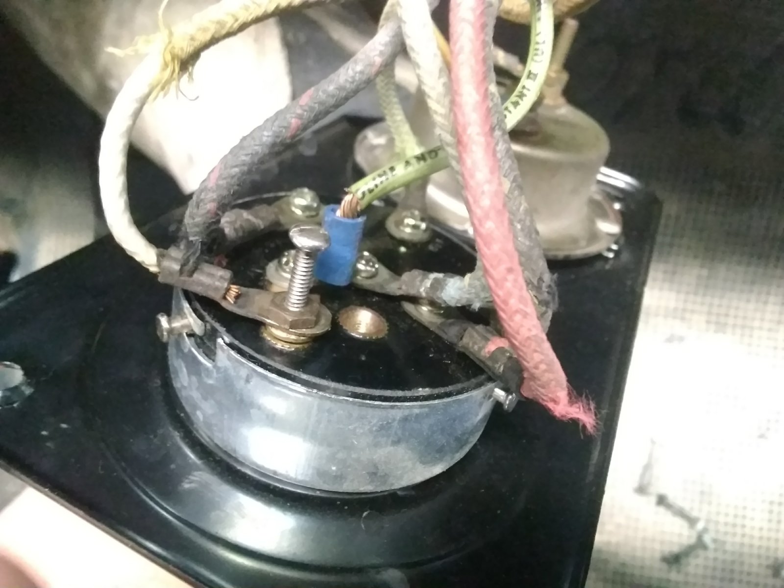

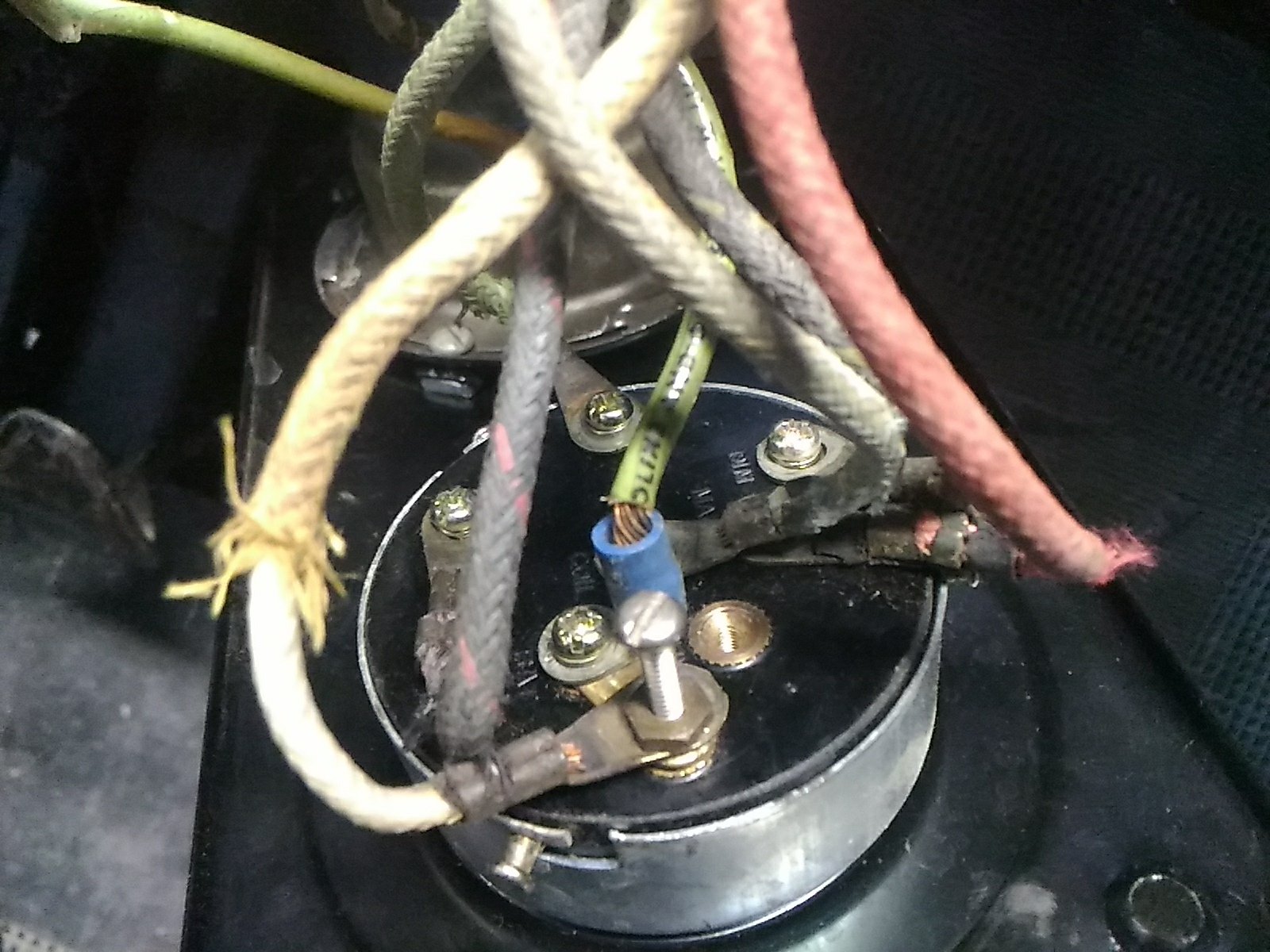

A few days ago I taught my friends mom to drive my 24 touring and while we were going around the block, the headlights just shut off suddenly. Any ideas? I talked to John Warren and the tips he gave me did not work or I probably was not doing it right. Here is some pictures...
- Posts: 4089
Re: Headlight problems
From your headlamp photo, appears the wire just is pulled away from the socket.
To fix, twist off the threaded cap, and expose the end of the socket, use a tiny screw driver and back out the retention screw. Insert the wire, then tighten the screw. Don't back that little screw all the way, easy to loose it, and hard to replace that special thing.
Your switch seems to have funky long screw on one terminal, best to find a proper short one to match the others. Keep all terminals from contacting each other there. Take caution, the hot yellow terminal touching the red magneto wire terminal can cause a dead magneto by killing the magnets.
Battery lights are in parallel, but magneto lights are in series. So it looks like the problem is in the wire or the socket on that side of the car. Your picture looks like the wire is out of the socket. If it were in the switch, neither light would burn.
- Posts: 4089
Carson
Your dash terminal block wiring is odd.
There should be just 6 wires from the Switch 7 wire loom going to the top of the terminal strip, the 7th Blue wire in the switch loom is Coil switch terminal to the coil box.
The 6 wires (Left to Right) are Yellow/Black- Generator/to Bat switch terminal, Red to Mag switch terminal, Yellow to the Ammeter terminal {a short jumper wire from other Ammeter terminal to Bat switch terminal} , Tail to Tail switch terminal , Dim headlamps to Dim switch terminal, Bright headlamps to Bright switch terminal.
The lower looms are the headlamp/tail/battery/magneto loom and headlamp/timer/generator loom. Both headlamps get two wires each, a dim and a bright side. You can see those wires on the lower right side of the terminal strip, connecting to the switch loom wires of dim and bright.
Make a check of all your wiring while you are at it.
I don’t quite understand his terminal strip either. Looks like a jumper from the battery terminal (yellow wire) to one of the headlight terminals. If he installed that jumper, that could be why he only has one working.
