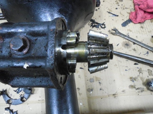

I’m still learning, and I’ll call it providence that I had the misaligned washer. While I had the drive line disconnected I looked at the Hyatt bearing behind the pinion gear. It is in pieces and totally shot. It’s a miracle it was working without ??

Yep, that's toast.
Time to inspect and measure the shaft.

I’m trying to figure out we’re the top half of the roller bearings went. I found one finger nail size piece and nothing else.
r/s Bob

As long as the sleeve is not spinning on the driveshaft it should be ok. BUT! One overlooked thing is the area is where the bushing rides on at the other end. The shaft can be turned down and polished and a custom undersized bushing installed. Chances are that with the condition of that bearing at the pinion end, it will need attention.
