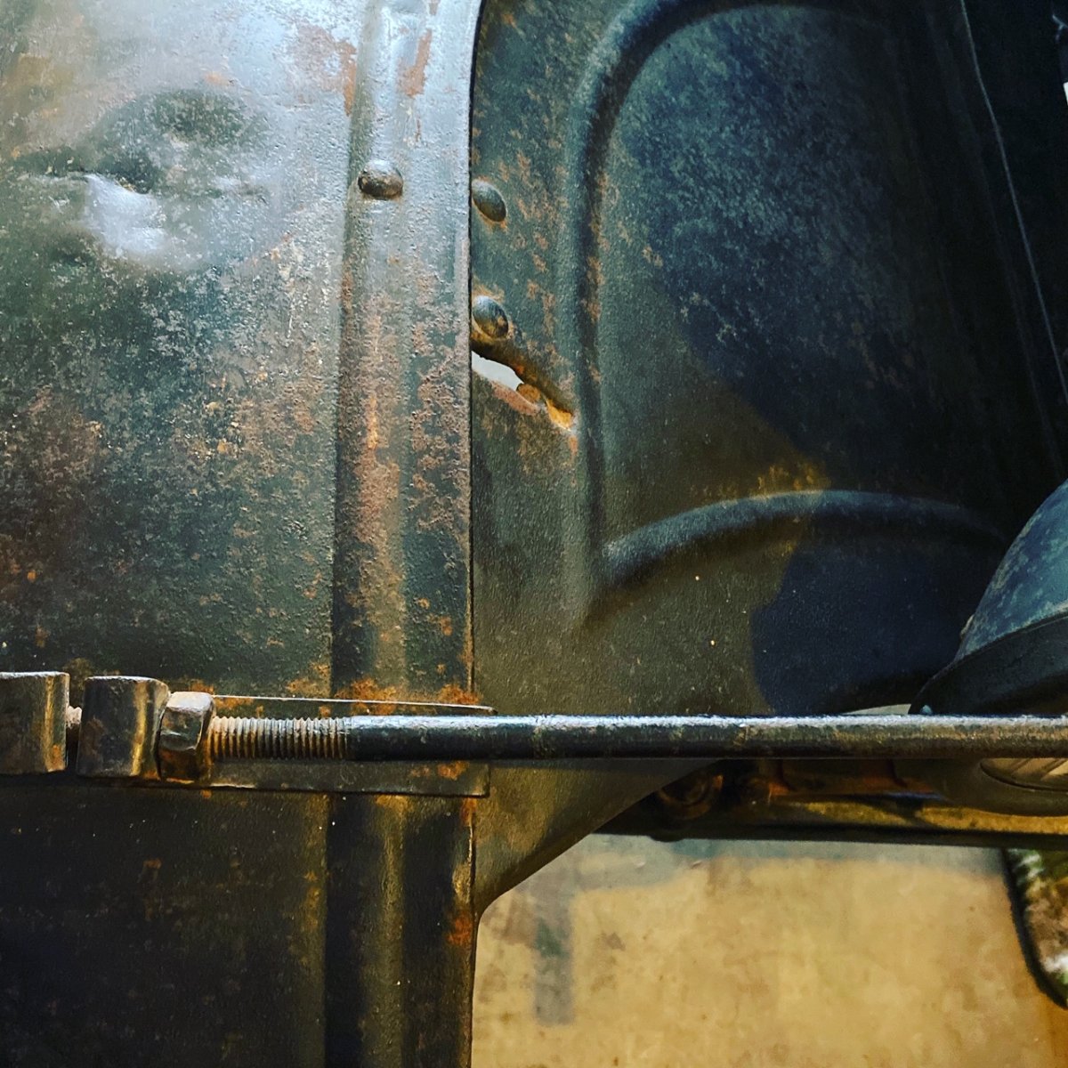

I've wondered, since I bought my car, how this damage was done to the passenger side fender.

IMO, that damage was from an outboard strike.
Could have been done by an errant fan blade.
Or someone thought a ravine there would be handy place to prop one side of the hood open.
Most likely a stress facture, the inner bracket plate terminates about there, leaving the fender metal free to flop and crack.

I think it would take some quick and sharp force to tear the metal like that. None of the other metal around it seems to be deformed including that bead right next to it.

That damage is a puncture. Enlarge the photo and you will see the edge of the brace is nicked. Fatigued sheet metai will crack, but a rigidly riveted area will loosen and crack thru a rivet hole if the rivets become loose. A slight bend that works back and forth will fatigue and crack ALONG THE BENDING area only. A puncture hole starts out as a stretch around the penetrating object, this in turn carries the future hole edges down from the surface which action results in a puncture hole. These fender hole edges are classic puncture edges.

This damage looks to me like a broken off fan blade that hit the side of the fender and punctured it.

I think Ron got it correct. The trajectory of a loose fan blade would be slighty upward from that side. Probably no hood, as its doubtful a blade would penetrate a hood panel and still have enough energy to pierce the fender skirt.

I doubt a fan blade had anything to do with the damage. A flying blade would have a trajectory almost parallel to the inner fender panel, resulting in a sliding contact, which would surely have been impeded by the rolled edge of the fender top surface. There is no damage to that rolled edge. The rolling of the edge of the damaged area indicates to me a considerable downward force was responsible for the penetration. The dent to the top of the fender need not be connected to the puncture incident.

I'll take separated fan blades for 100, Alex! When you look at the slot, it came from the bottom traveling up, and was stopped by the lip in the top of the fender. If it were something come down from aboce, it would have either nicked the top surface, or the bottom of the hole would be larger than the top. Instead, it looks like a blade that cut loose from the bottom of the fan into the sheet metal of the apron, went sideways into the fender, and stopped there.
