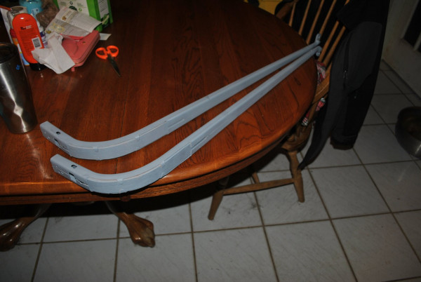

My "new" top bows arrived today
Very nice work John thank you a lot now maybe I can finish this '25

Re: My "new" top bows arrived today
Those are gorgeous G. R.!
