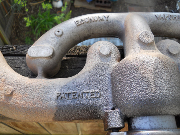

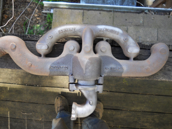

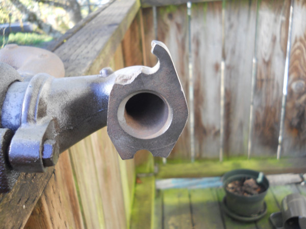

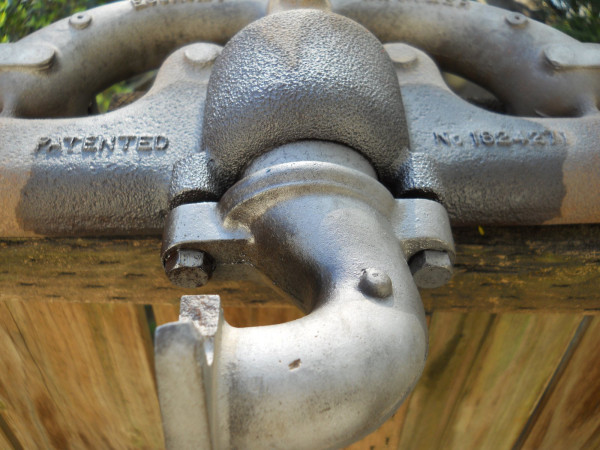

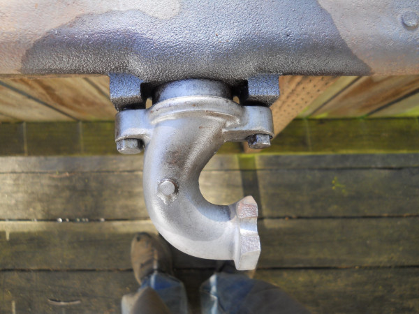

I got this Economy Vaporizer and was unable to find any Patented info on how it was put together. generally I like to look at things and figure it out but this one has me scratching my head. Has anyone pulled the intake tube out of the exhaust part? Does it slide in or screw in? Or does the neck just meet up with the tube and held in place the the 2 bolts? Or? I would like to remove the neck so I can repair the flange where the carb mounts. The Pat. No is: 1824271

The casting patent # is wrong. The correct patent # for that manifold is 1624271
https://patents.google.com/patent/US162 ... nt+1624271

Thank you for the link. This one is same but different. Before I saw the link I tried the number changed to the 6 and still came up blank, glad you posted the link.
