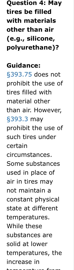

- Posts: 4089
Re: foam filled tires
Dan
Just checked DOT and rules don’t forbid foam specifically, but guidance says materials other than air could be against rule if these materials affect tire performance. Maybe too an insurance liability issue to use anything other than what the pneumatic tire mfg. recommends.
