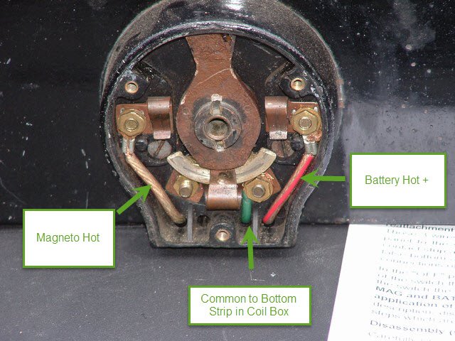

I am putting together a 15 coil box and switch Lang's parts book shows three wires one going to mag one going to bat and one going to Common where does the common wire hook to I've never tore one of these apart so I have no idea your help would be appreciated thank you

Common would go to the coils.

The common would be connected to the bottom strip of the coil box witch is the bottom of the coils as stated above.

I know one in goes to the strip where does the other end go to the switch and where

The wire goes from the bottom strip of the coil box to one of the bottom screws of the switch

Thank you very much for the picture and the statement I was thinking that's where it went but I wasn't positive thank you again
