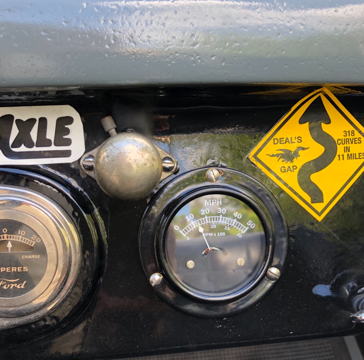

Noticed where a new way of calculating speed (and possibly engine speed - rpm) by measuring magneto out put. The meter has been presented on the forum.
A meter that allows for measuring the output of the magneto.

As for the new mag. speedo/tach I can say if car isn't moving you kinda know, there isn't any wind in your face.
But at idle the T is shaking, so you think you are, unless you notice you're not passing any trees, houses, or signs!
Meter display about 500 RPM's at reasonable idle, of course not moving.
Happily running around my neighborhood, a bit under our posted limit of 25mph. Meter is fun to see the speed.

I designed something similar to this a while ago (at least I assume it's similar - if there is any detail it'd be interesting to see?).
Mine was effectively a rev-counter also calibrated in MPH, driven either by magneto, timer, or magnet/hall effect device on a wheel.
For the magneto drive I used a MEMS gyro/accel on the gear pedal to determine which gear was in use, or if the vehicle was in neutral. This utilised the angle of the lever arm. The code (I used an embedded micro to translate the input to various meter output types) would 'calibrate' the meter in MPH or KPH according to the requisite gear/frequency ratio, and if in neutral would return the meter to zero. The latter was ok if you weren't coasting!
It's an effective way of returning speed from one of the several available inputs, but in the end I decided I quite liked the bareness of the 'instrument panel' on the T
A personal choice, I can see the attraction and may return to a variant of it at some stage, it's good to see others doing this as well.

Matt, great minds think a like. I started on an "E-Dash" project a while back: a magnetic mount, 2 line LCD display powered by 2 wire connection to the Magneto post that would simultaneously display:
Speed (MPH) Magneto Voltage
Engine RPM Engine Temperature
Micro controller based, of course, so MPH easily calibrated regardless of gear ratio or tire size combo, and programmable engine coolant alarm in the event of rapid temperature rise associated with oil loss or cooling system fault. Speed warning possible too but generally not an issue in a typical Model T
I too decided to abandon development as it would be an unwelcome modernization clearly visible on the dash even though it was mag mount and easily removed. Then again, GPS displays seem common in many Model Ts.... Perhaps something to consider again if sufficient interest in such a device warrants. Deriving noise free DC power to operate a fragile uC from the Magneto while firing coils generating voltage spikes up to 300V was a real challange.
The new Speedometer/Tach is informative and looks period correct. Very nice design John.
