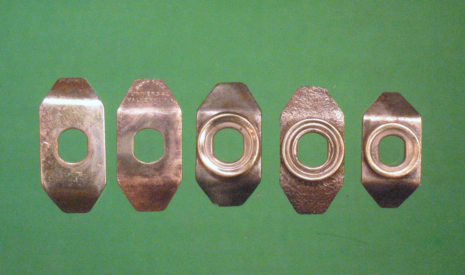

Post by Steve Jelf » Sun Apr 12, 2020 10:56 am
No such problem here. I always use them.
The bridge washer on he left is one of the inferior modern ones. I always use the ridged ones. Without that ridge pressing into the rubber I believe leaks are more likely.

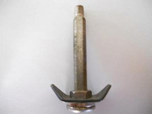

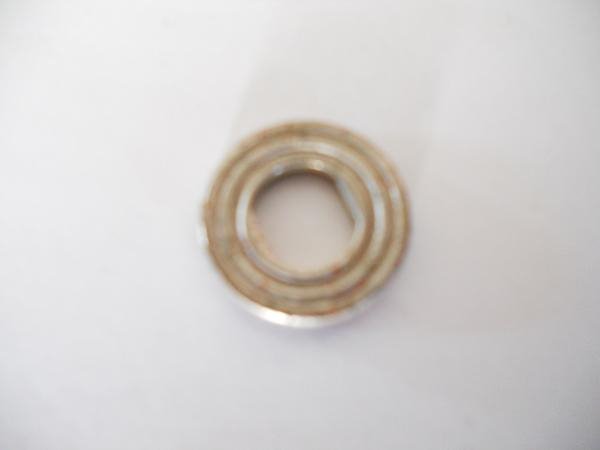

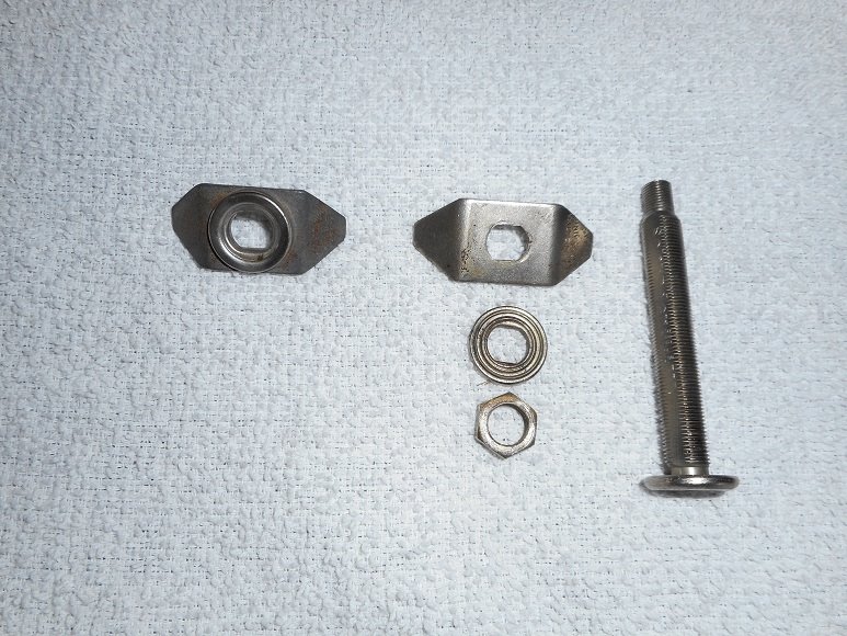

I think I posted a photo of the second to the left Schrader bridge washer recently, along with the separate washer that went under it. Just after that, Schrader began to crimp the washer to the bridge washer. The sequence is pretty clear looking at the rest of the bridge washers posted.
Bridge Washer 014.JPG (77.62 KiB) Viewed 5851 times
Bridge & Ring Washer.JPG (24.87 KiB) Viewed 5851 times

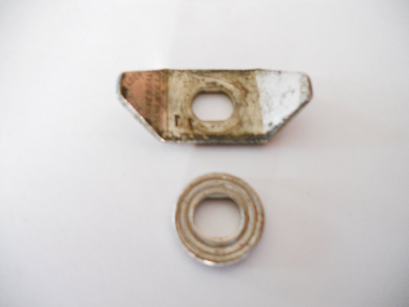

Post by Original Smith » Mon Apr 13, 2020 1:00 pm
I just found another photo of the early style bridge washer. I second style bridge washer is on the left.
Tire Valve Assy..JPG (15.55 KiB) Viewed 5830 times
