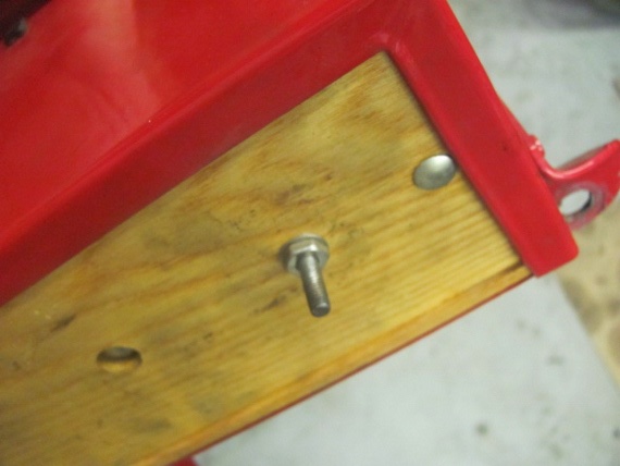

Removing the distributor and putting a coil box back on my 1927 Touring.
There is a strip of contacts in the bottom of the coil box but I am unable to see where it connects although I see a wire coming out of the bottom in pictures and no idea where it goes to or how it connects to the coil box. I only have one screw holding the strip in the bottom and it does not protrude out the bottom much.
A little help please!

The hot wire from the switch (COIL) terminal, goes to the bottom of the '26-'27 box, that powers the coils.
IMG_3909 (570x428).jpg (79.42 KiB) Viewed 2978 times

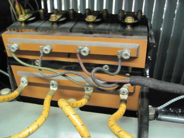

Remember the engine mount box plug wiring is different from fire wall mount box. On the engine mount box, the terminal on the far right is #4 plug!
Of course the timer wires are the same color code for proper firing order to the plugs.
