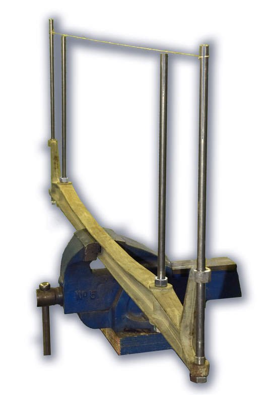

I am wanting to make a set of gage rods for checking the alignment of the front axle to the spindle and perch bores. I am thinking, make a set of cones to fit 1/2" ground rod into the perch bores. Then on the spindle bores 1/2" ground rod slipping through the top hole and machining a step, or taper to fit into the threaded hole on the bottom. How long should I make the gage rods? Does any one have any thoughts, or ideas on this? Does any one have pictures of a set that they can share.

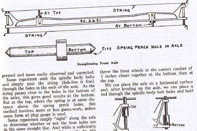

Post by TRDxB2 » Tue Apr 14, 2020 12:02 pm
Need o search the old forums to see where I got these photos

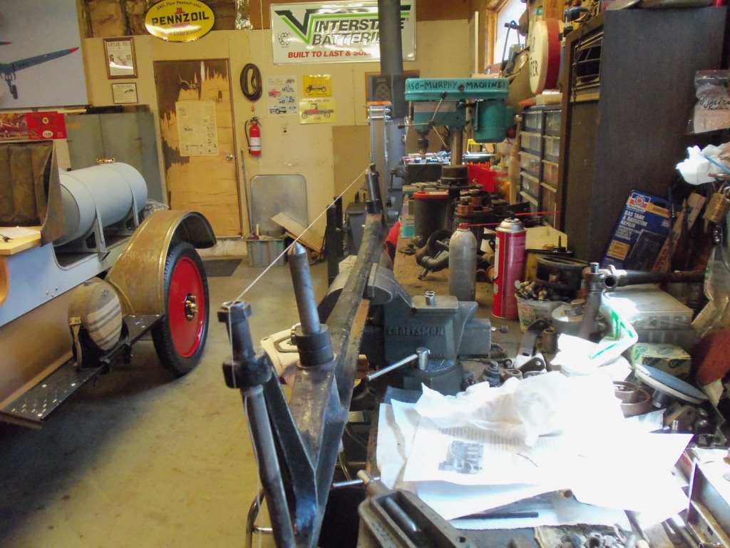

Post by RajoRacer » Tue Apr 14, 2020 12:04 pm
This is what I came up with - works quite well.

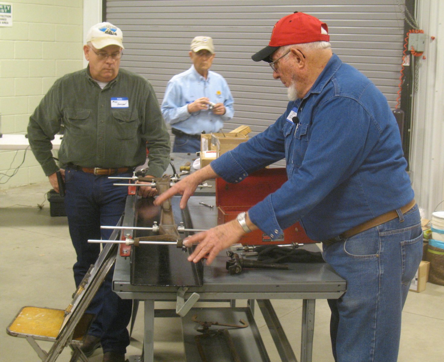

Post by Steve Jelf » Tue Apr 14, 2020 1:07 pm
Here's the rig Bud Redding uses. Rods through tapered plugs that center in the holes.

Re: Front Axle Alignment Tools
Post by Harry Lillo » Tue Apr 14, 2020 3:20 pm
I have used twin tapered collars with thumbscrews on 3/8 rods for many years. Very similar to the picture above.
You can tell immediately if the axle is twisted. Very easy and quick to turn out on your lathe.
Harry
